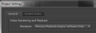

    I had same error- I turned off gpu rendering for playback engine and it fixed it.

    Thanks, omaudio
    I had one clip that was causing the issue, and temporarily turning of the Mercury playback engine during export resolved the problem.  Thanks for offering that as one of the solutions.
