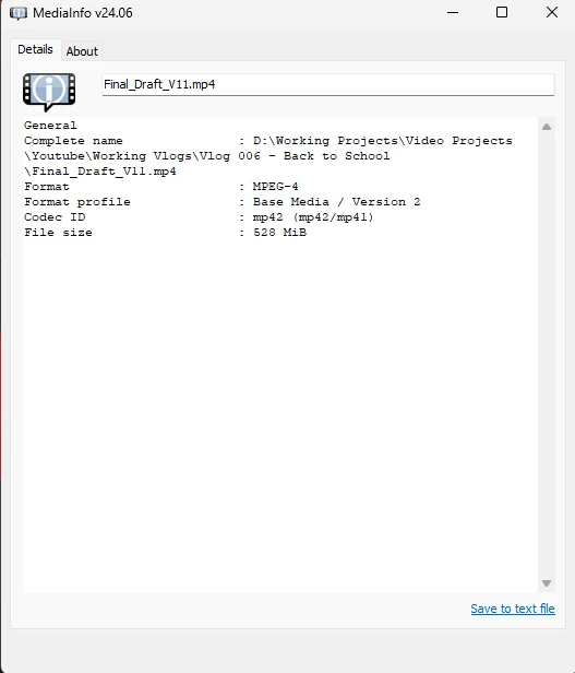

What's the original media, and created by ... what? All the details, and a screengrab of the data in a MediaInfo "Tree View", dragged and dropped onto your reply box, so we see the pic directly, is about the easiest way to do that.

I'm not sure if I'm understanding/doing this correctly, so please let me know if you need any more information! I've attached a screenshot of what appears in mediainfo when I upload my most recent attempted export, and I've also attached a text file for the mediainfo display for a clip of the original media. Thanks so much!

I'd look for obvious errors or glitches in the video. You can also try running yhe original video through the app Handbrake to see if it will fix the problem.
