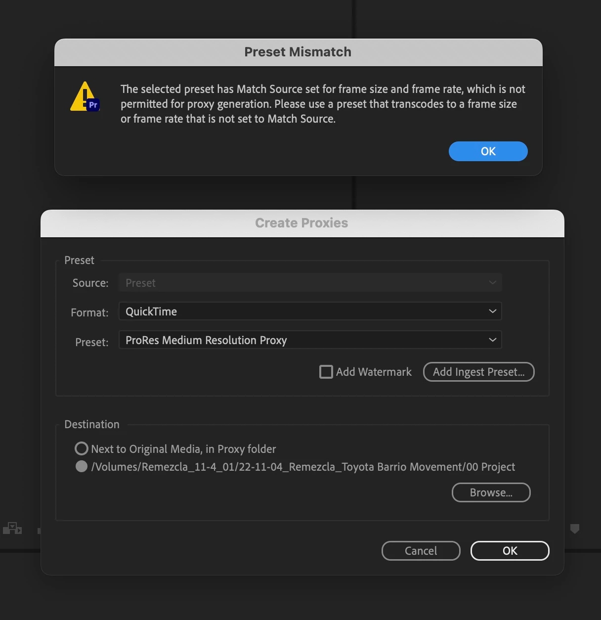

Trying to create QT proxies with a LUT in Premiere 2023. Click on footage>Proxy>Create Proxies. When Adding an Ingest Preset, I keep getting the warning:
"The selected preset has Match Source set for frame size and frame rate, which is not permitted for proxy generation. Please use a preset that transcodes to a frame size or frame rate that is not set to Match Source."
I created an Encoding Preset, then used that to create an Ingest Preset. Match Source was NOT selected for any parameters. I tried again creating new Encoding and Ingest presets but to no avail. Any tips would be appreciated!

Double Check that you have the correct preset selected in 'Ingest Preset Settings' window.
I had this same issue, took me 20 minutes to figure it out.
this is what I was doing wrong.
in Media Encoder -- when I right click on a preset and select Create Ingest Preset...
it DOES NOT mean you are creating an ingest preset with that .epr preset.
you will still need to SELECT the preset in the 'Ingest Preset Settings' window.  This is why the error keeps coming up. It's actually using a different preset that does have 'match settings' selected.
