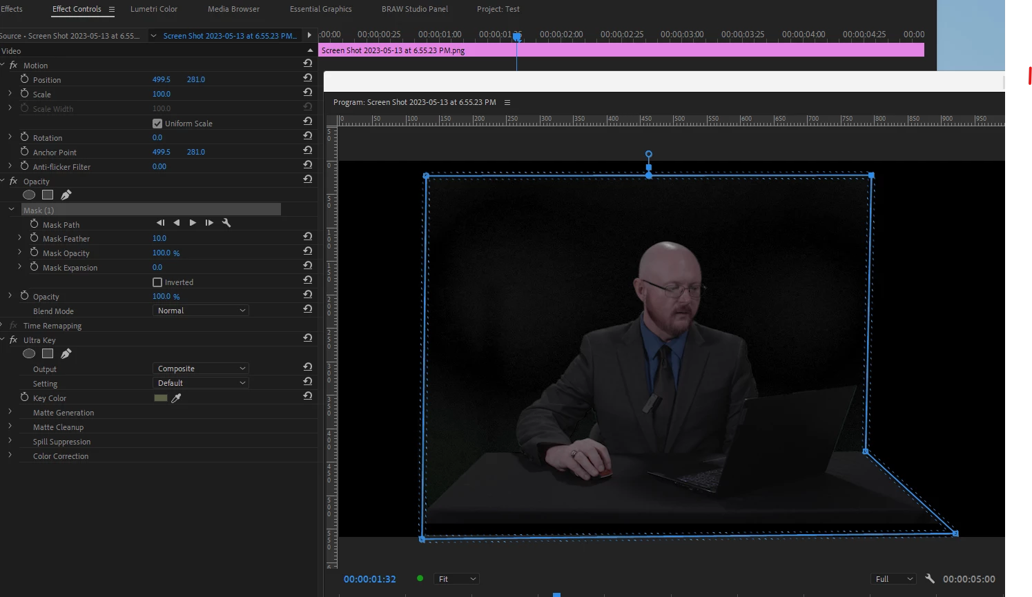

Having an issue trying to key out an area of green screen that was not shot in the original footage. So I have two areas on either side of the green screen that did not have full coverage. I need to expand my ultra key to include these areas without having to use the dropper tool to select the color I want to key. One idea was to fill the area with a solid color then select that to be keyed out in the green screen selection. Any input about this would be so helpful. Thanks.

You could try using the mask option for the opacity, then add the ultra key.
