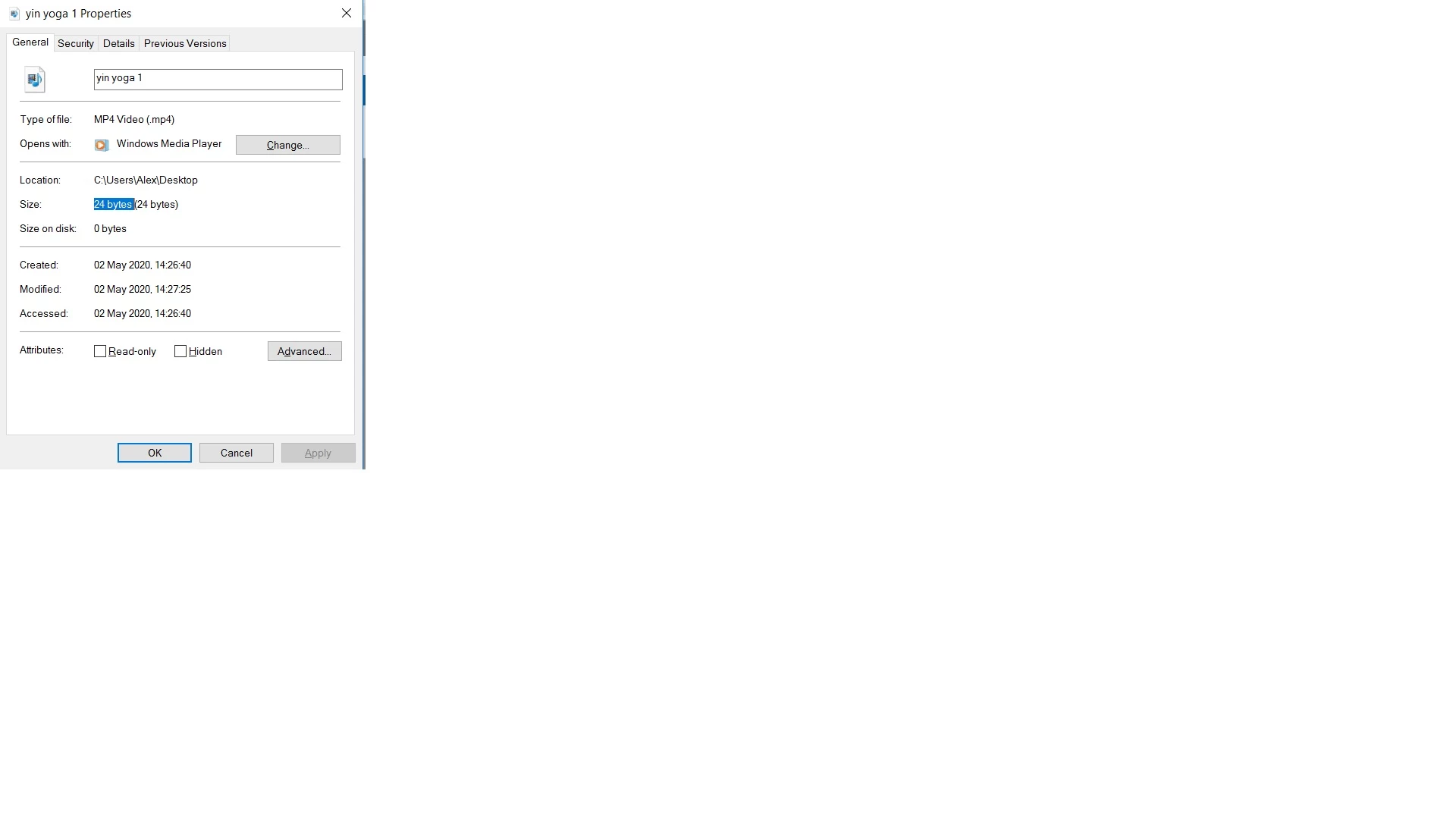

Are you sure its the same file: names are different.
4W3A6072 opposite yin yoga 1
alexgiagAuthor
May 2, 2020
yeap, I renamed the file before the export 🙂
alexgiagAuthor
May 2, 2020
this is a print screen of the export settings
as well as the file settings
