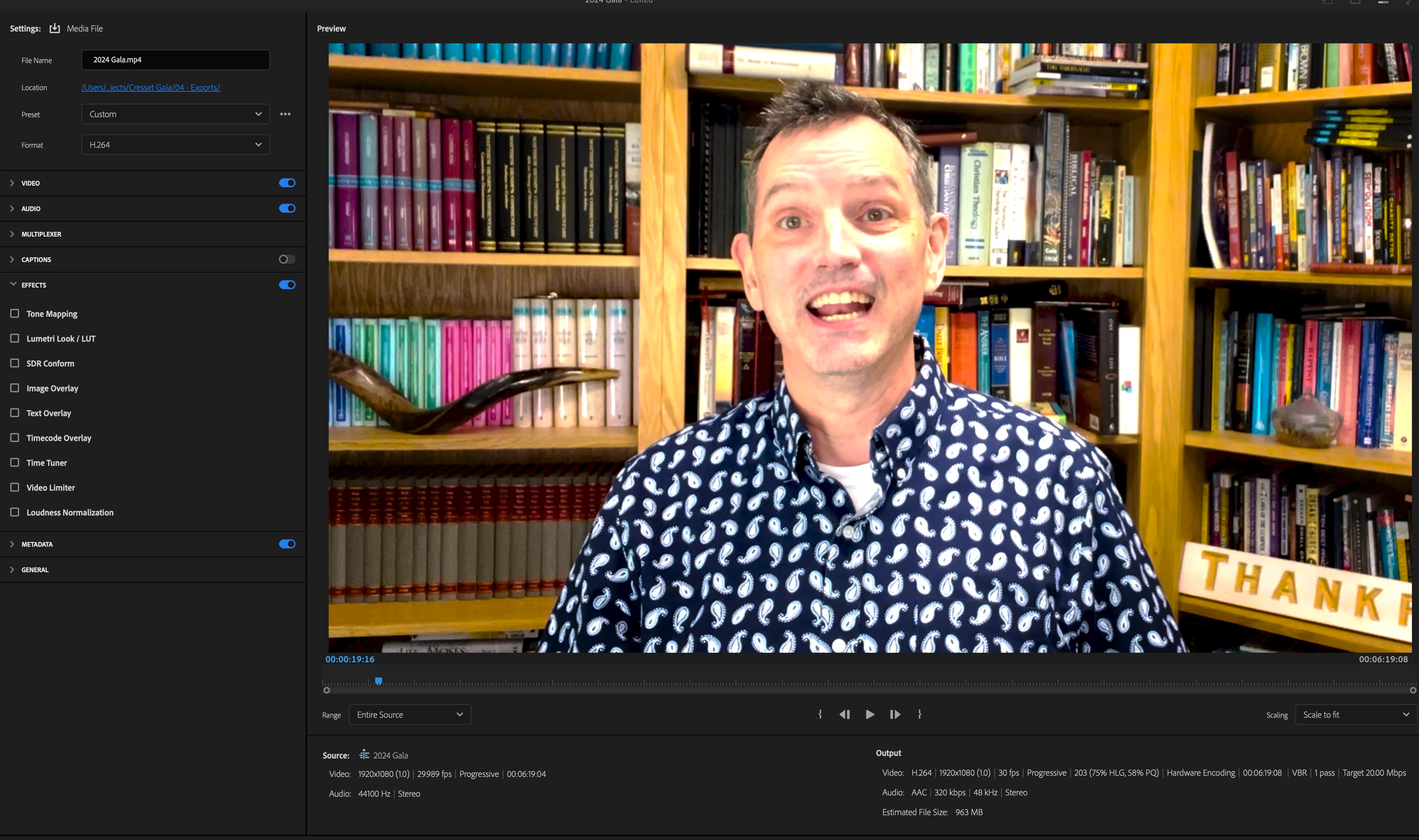

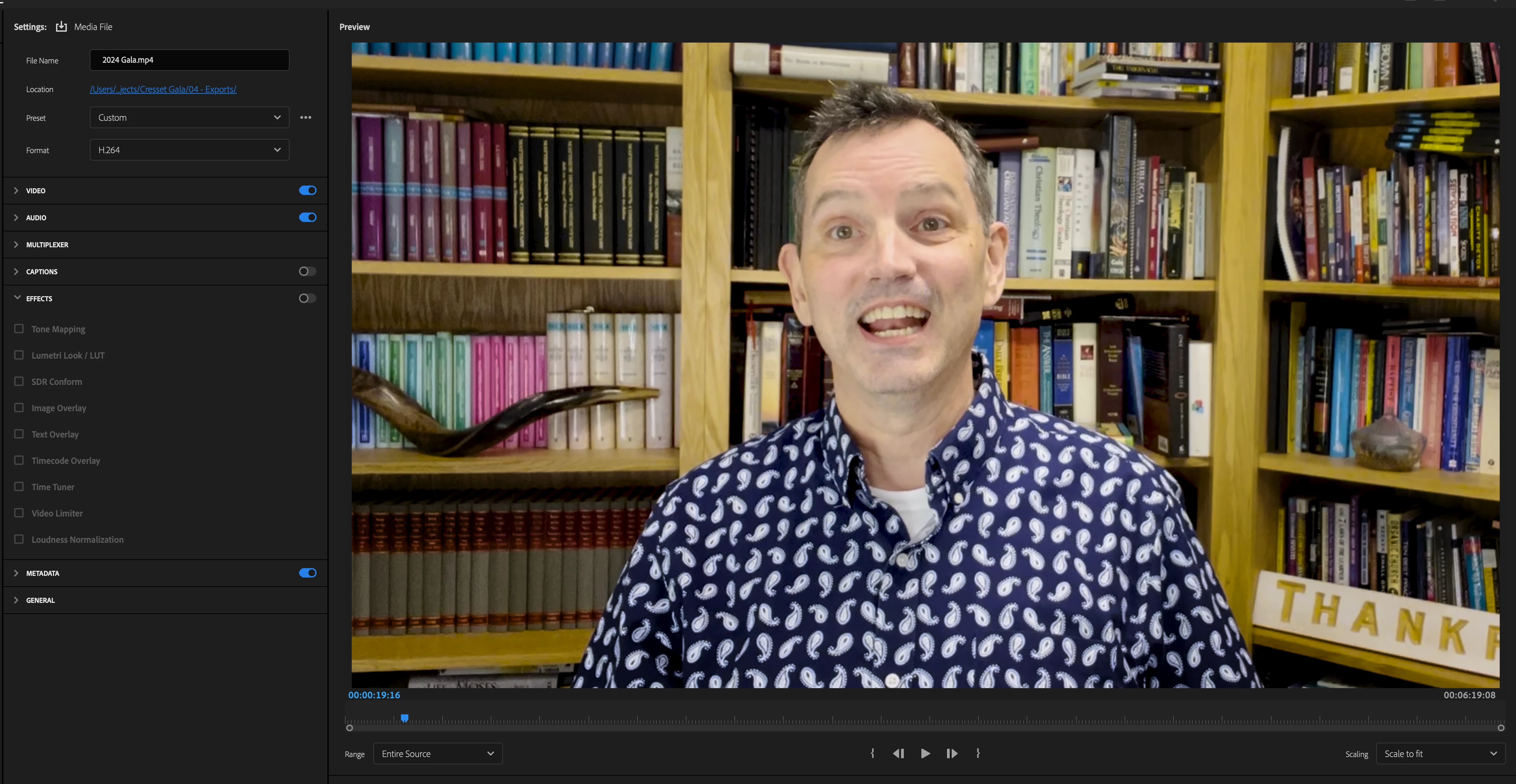

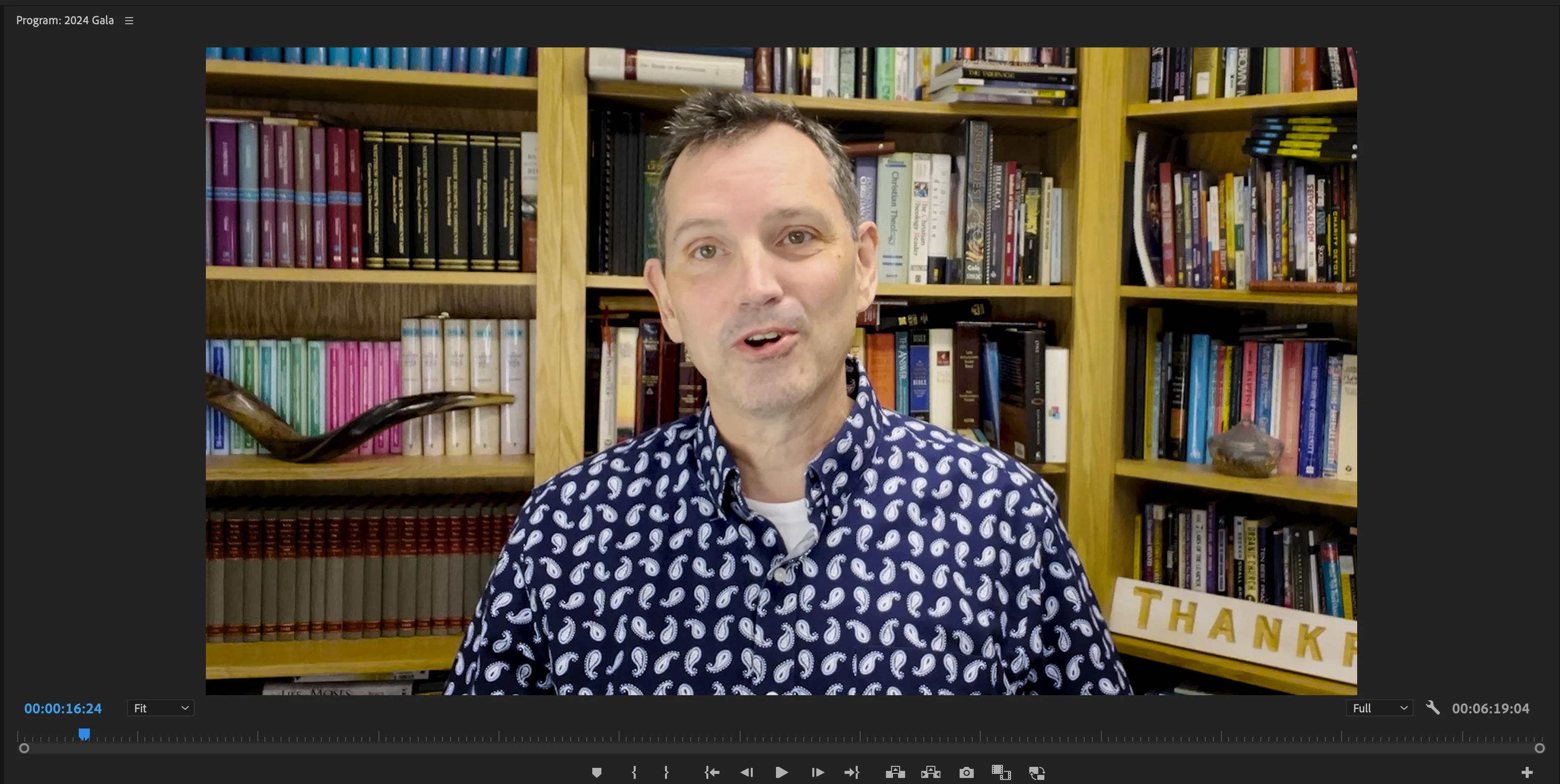

QQ - I'm sitting here in premiere 24, and in the program window, I have my colors the way I want. When I go to the export window (still within premiere) the colors are totally in a different color space, whites blown out, etc. If I toggle the effect option in the export window, everyone looks like my original footage again (but I lose all my grading, color correcting, etc). if I drop down into the effects section on export, nothing is checked.
If its apple's problem, why does it show two different ways within premiere? This is like the 5000th bug I've found in premiere 24 it feels like.
