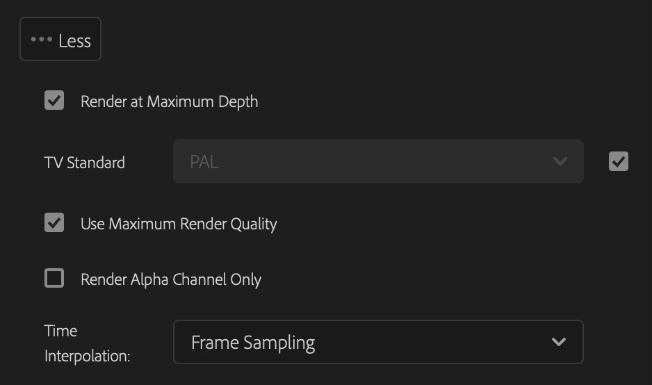

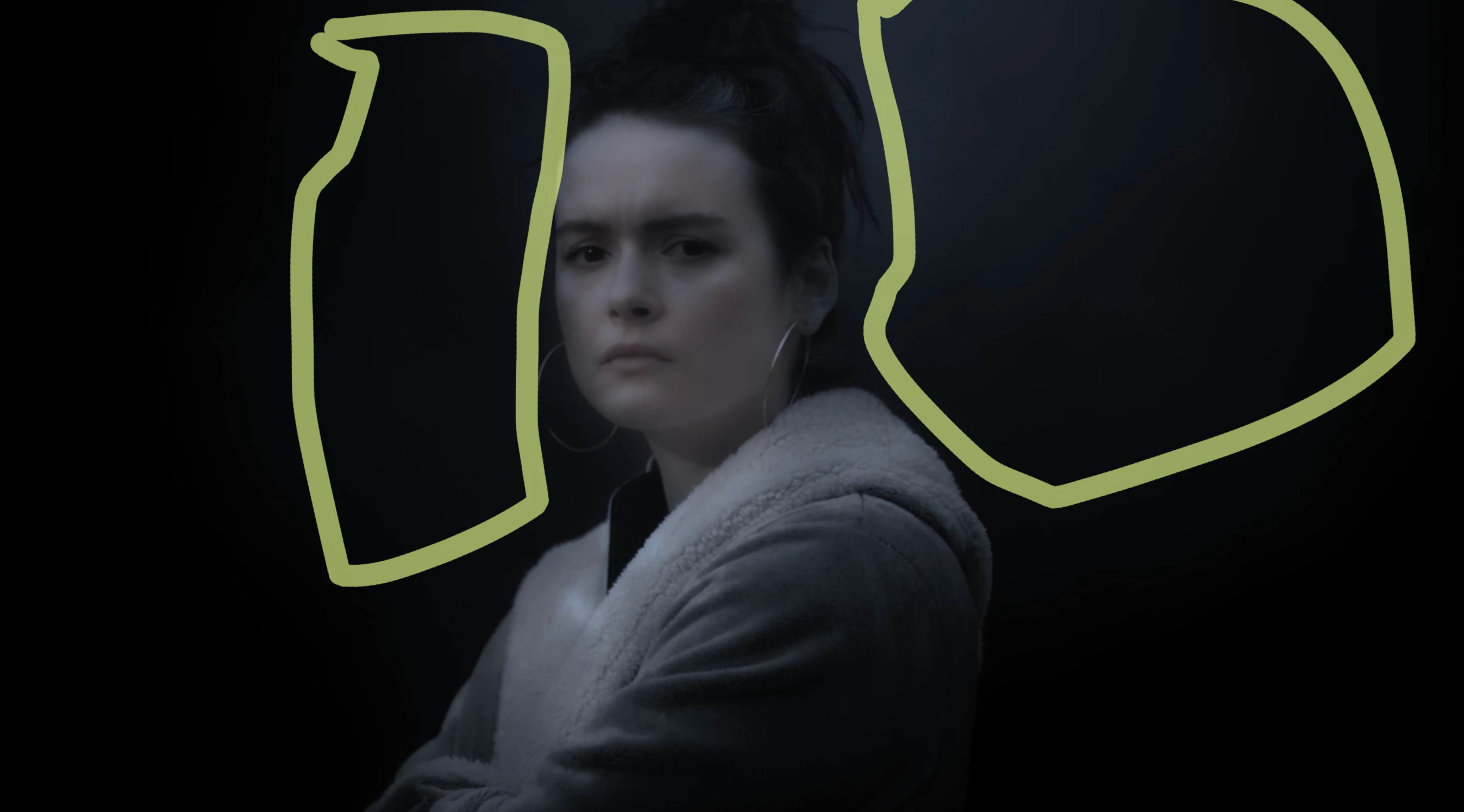

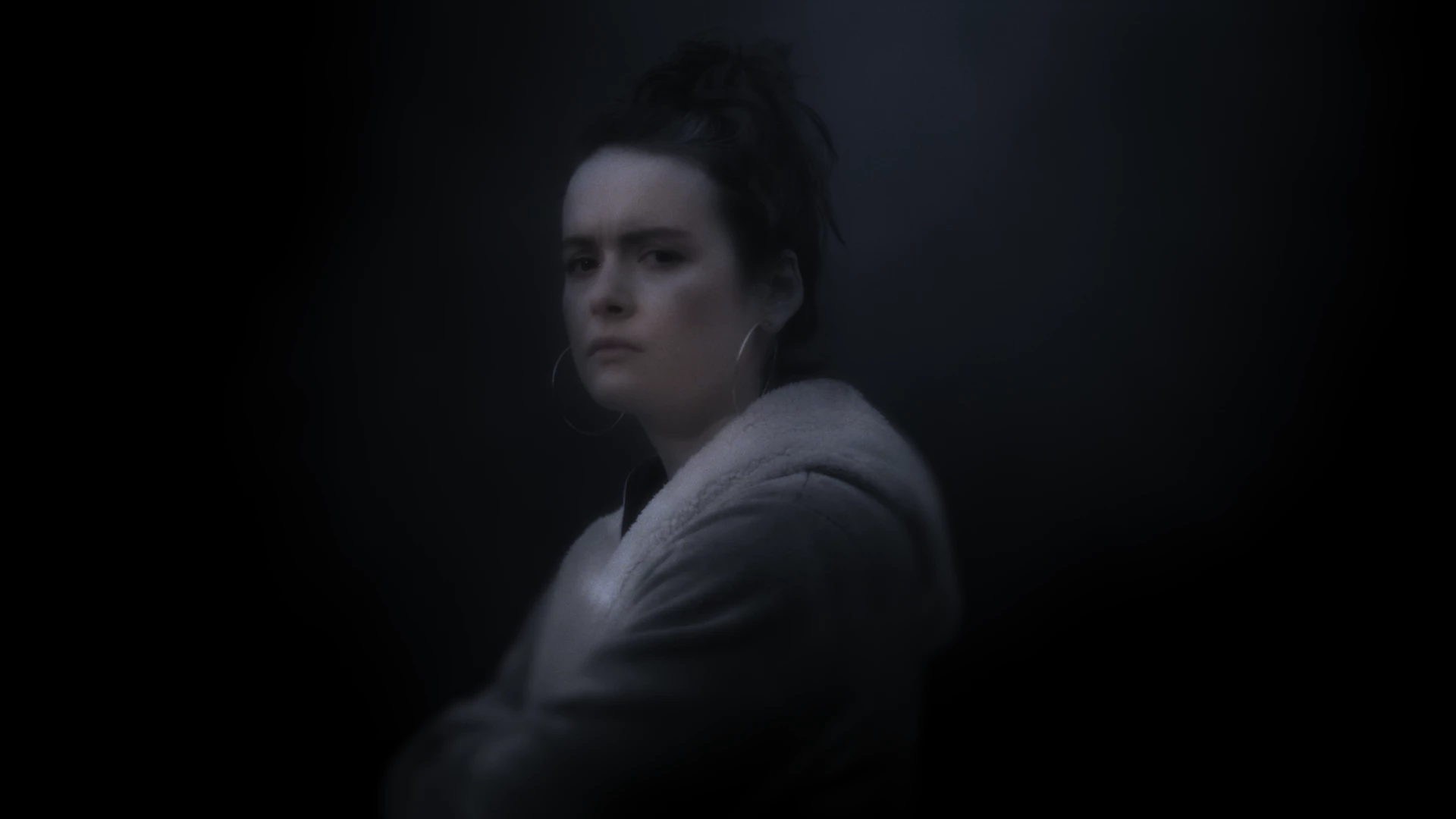

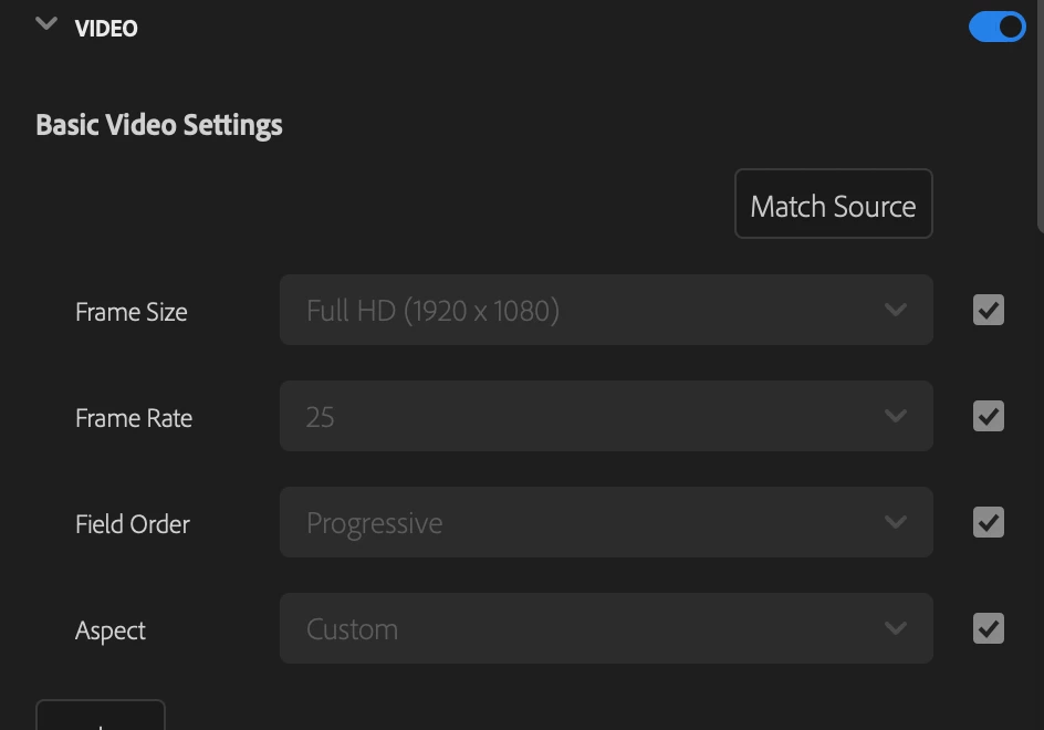

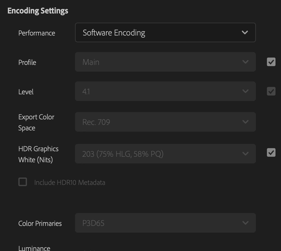

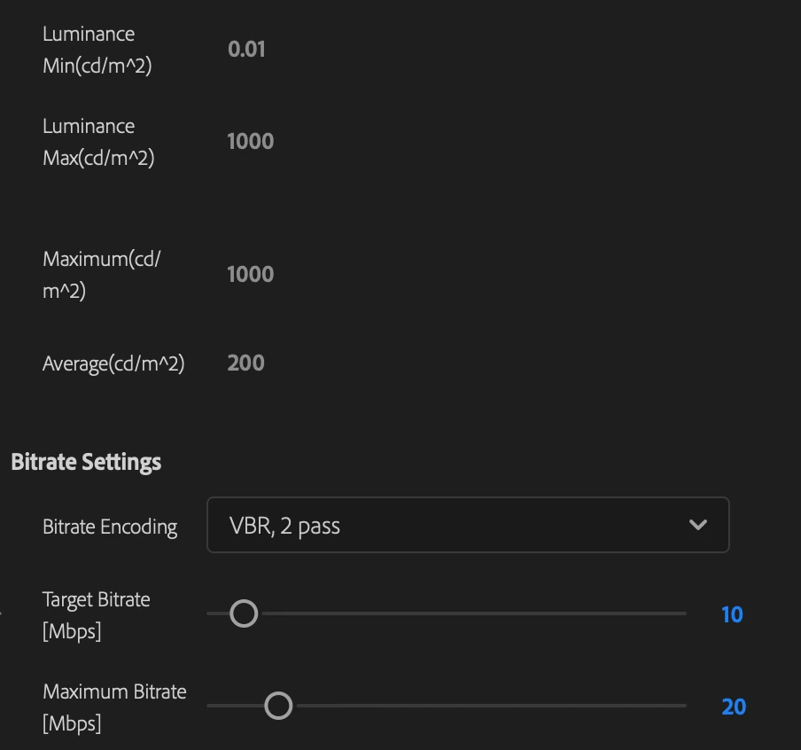

Hi, this is a Apple 4444 Pro Res file that I bring into premiere and export at these settings, it comes out pixelated and not looking great, how can I fix this?
It shouldn't be looking this bad
Images attached

What happens if you use CBR instead of VBR and also un-check Render at Maximum Depth and Use Maximum Render Quality. Set the CBR bitrate to 30.
You can also try to set the Key Frame Distance from 72 to 25.
And, how does it look if you render out to Apple ProRes?

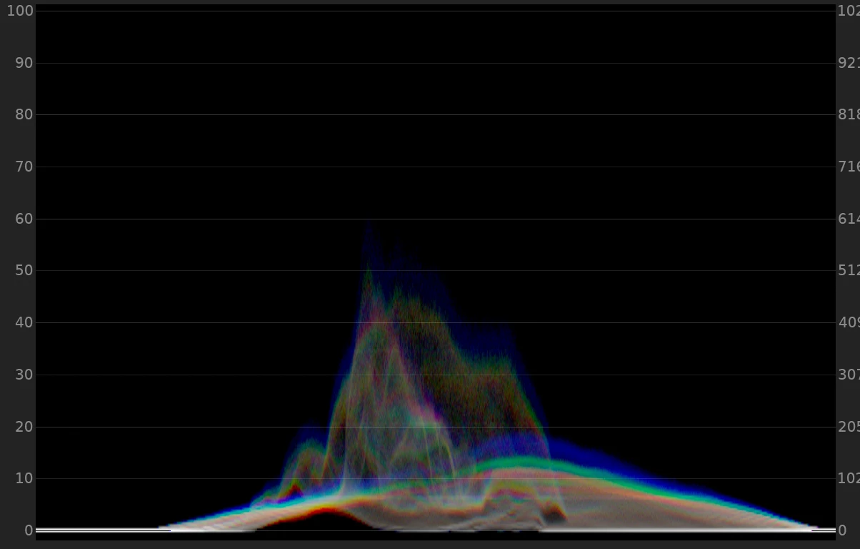

From what I can see of the actual image involved, it's very low on exposure. What did the scopes show of the image, Waveform or Parade?
Everyone's mileage always varies ...

Hey, the Pro Res 4444 file back grom grade is fine, its just when exporting that file to h.264
Waveform and also the export of the still to show how I need to get the mp4 looking

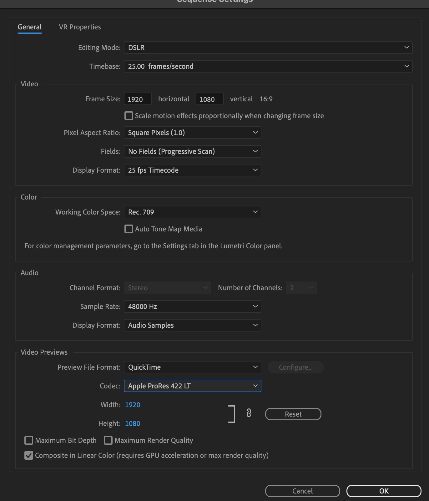

Please post comp specs, Premiere version and build.
Also screenshots of MediaInfo info in Treeview on footage used, sequence settings
https://mediaarea.net/en/MediaInfo
Please next time embed the images so we dont have to open them one by one.

Hi Ann, seuqence settings and media info below
