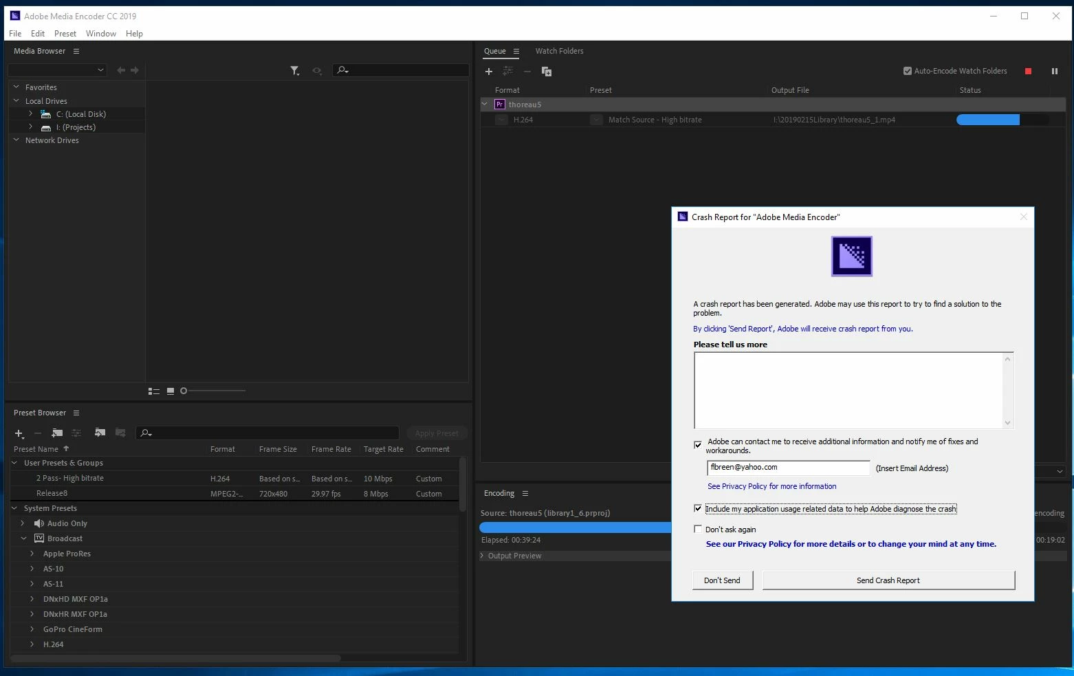

    Can you post a screenshot of the alert window you get when it crashes? Or find your crash log and show us what it says? Usually it shows where in your timeline Premiere Pro encountered a problem and that helps diagnose what's happening.
    flbreen9380904
    February 23, 2019
