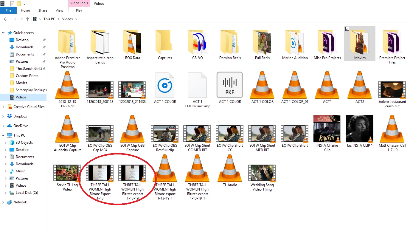

    This is actually happening to me as well. Here's a screenshot of a finished file and its doppelganger...
    Both finished MP4 files work individually, so not sure why Premiere is making two? If I delete one I have no issue using the other one...?
    Not really an issue but weird.
    Ann Bens
    January 14, 2019
    Your issue is different from the original question which is about mulitplexing.
    Open the properties and check the time when they were made.
