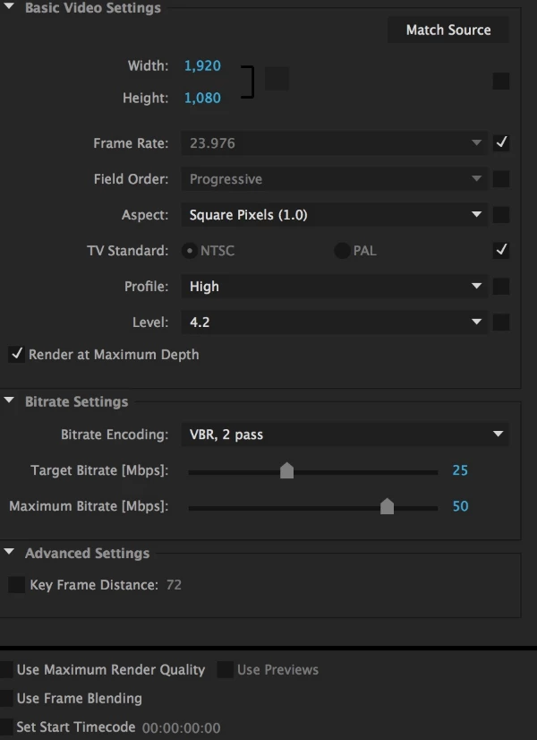

When I export to mp4 in h.264 or .mov in various flavors of Apple Pro Res I can no longer use the "Render to maximum quality" or "Render to maximum depth" check boxes. If I do the result is an export with a couple stops of added brightness. The attached images show the frame exported without those 2 buttons selected and with them selected. The one with blown out highlights is WITH them selected. Any ideas? This is way beyond the typical Premiere/Quicktime gamma shift.

ericas90264024
November 6, 2018
Ok now we're on to something. The gamma shift DID appear when "max depth" was checked but not on "max quality." I had done this test previously to posting here but not with VBR 2 pass. Only CBR or VBR 1 pass. I saw the gamma shift on both attempts.
Would the fact that both tests you just had me try were using "software encoding" and not hardware?
Thanks again for spending the time on this.

So you should try the following workflow:
1. Use VBR 2 Pass (remember longer render times)
2. Diable Max Depth
3. Enable Max Quality
4. In my experience if you have all your drivers updated and use hardware acceleration having both ticked shouldn't change gamma. I use this for all my projects and never ran into gamma or any issues, But this is was on CC2018, CC2019 might have changes a few things,
Trust this helps you and gets you back on track
