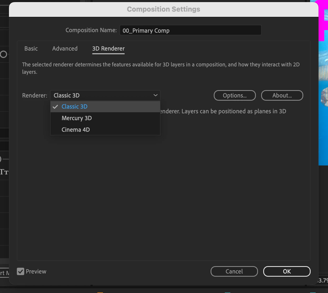

The Mogrt you shared with Kevin is using Cinema 4D which makes it a Dynamic Link Mogrt and not an AELib Mogrt. This means that the rendering of the Mogrt is done via Cinema 4D Lite and After Effects itself.
An AELib Mogrt is rendered within Premiere by a Tiny Inception Version of AE that is installed with Premiere. 99% of the time, being able to use an AELib instead of a Dynamic Link Mogrt will improve performance.
  • Do the parameters that require Cinema 4D need to be edited in Premiere?
  • Is it possible for you to PreRender those parts of your design and re-import them as footage in your After Effects Project and then re-export the Mogrt so that it can be an AELib Mogrt?
    • If this is an option, make sure to change the 3D renderer back to Classic 3D for the Primary Comp and all nested Comps.
