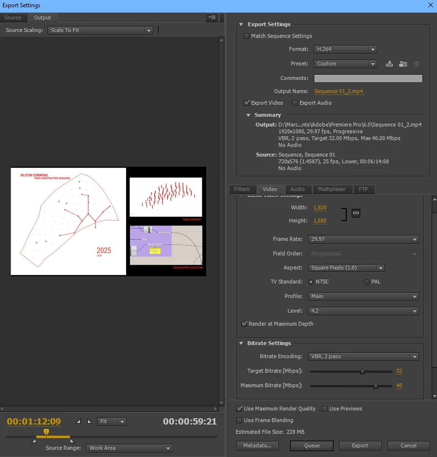

Post a screenshot of your export settings.
With the left tab to output and with an image.

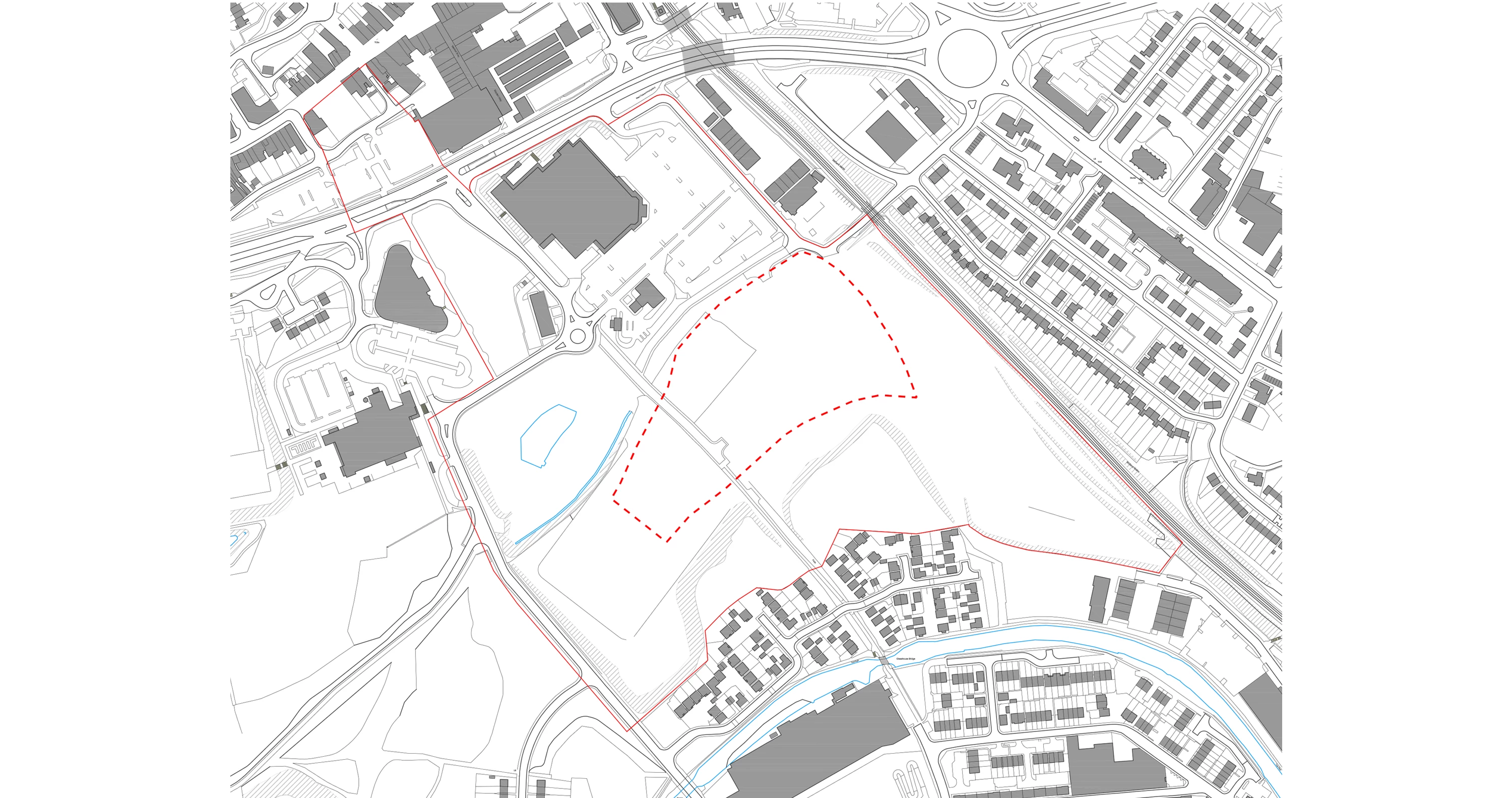

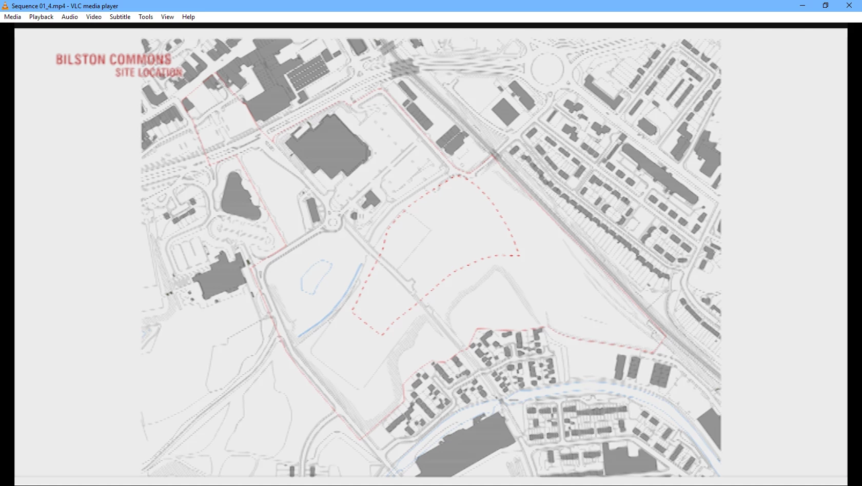

OK, attached as screen grab of the output setting i'm using, a screen grab of the video quality i'm getting and then the original image which is shown in the video screen capture.

I think you have a number of issues.
You have a widescreen interlaced standard definition sequence at 25 fps
You have varying size assets with different frame rates that have scaling and motion added
You have very fine peak red lines on your stills
You have a peak white background
and you are exporting a progressive HD file
I would strart again with a 1920x1080 progressive sequence (or make a sequence the size of you most common still)  and make your material fit that, you might be able to copy and paste your footage over but it might need re scaling.
