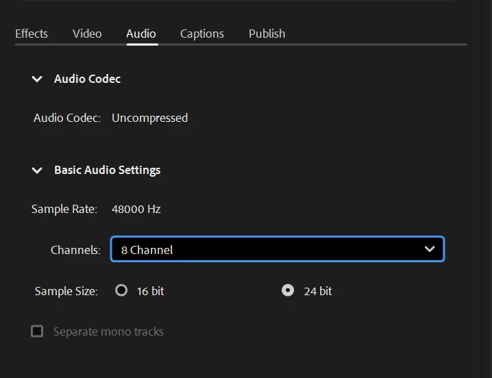

As for the 8 discreet channels of audio, in the "Audio" tab of the "Export Settings" dialog, make sure you have "8 Channel" selected (see screenshot).
