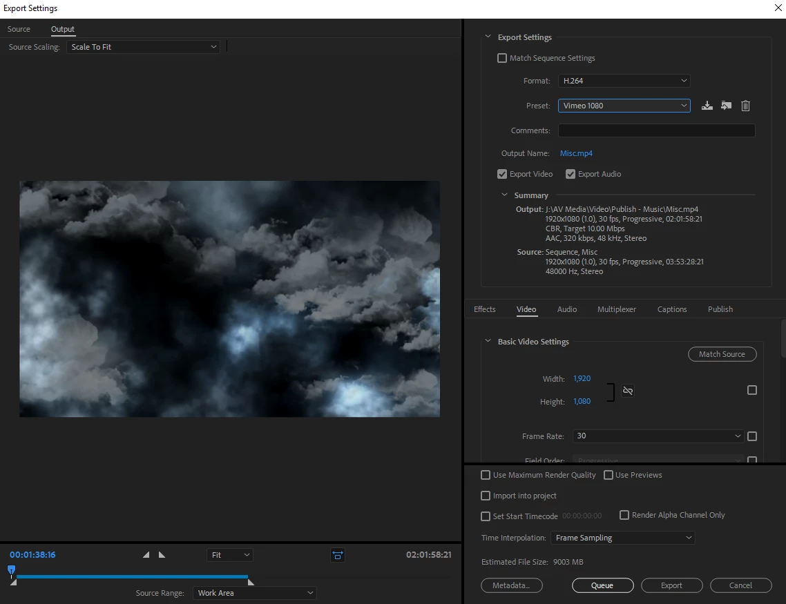

    Post screenshot of export settings of the mp4 with left tab to output with an image.
    unc417Author
    March 19, 2018
    Ann Bens
    March 19, 2018
    Try vbr 1 pass.
