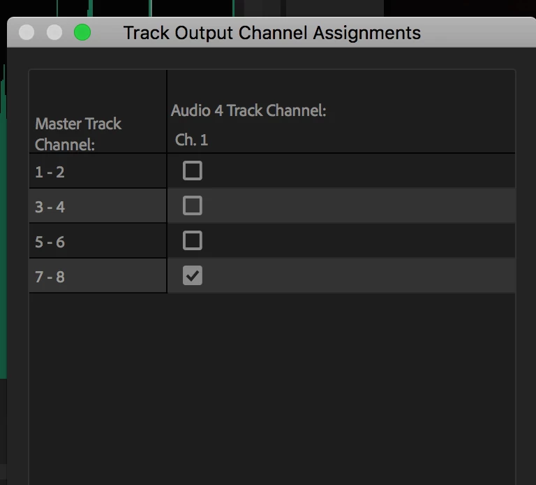

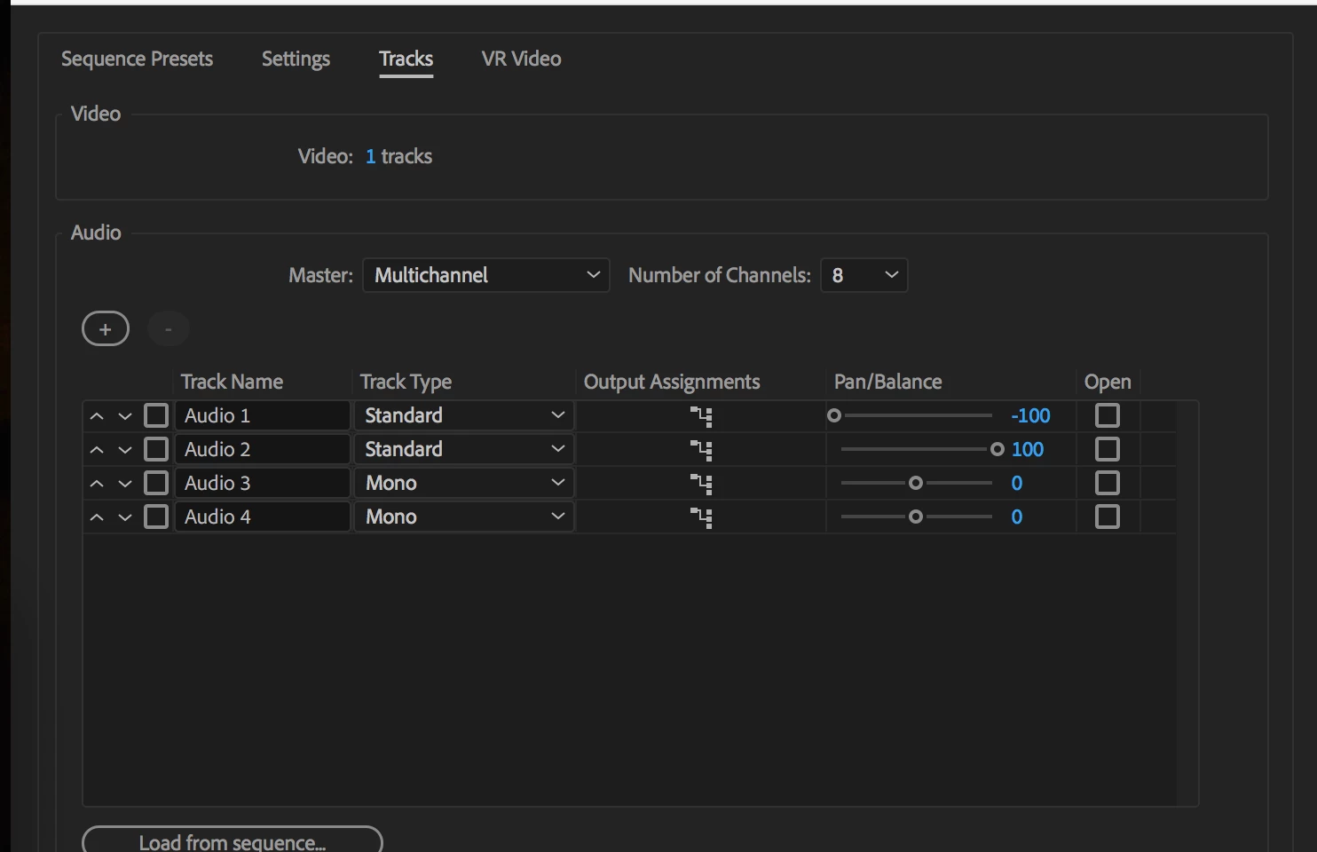

I received specs for delivery intended for broadcast. But, I'm having a difficult time wrapping my head around the Audio section where it says "Chan 1 Left, Chan 2 Right etc. The problem is, I'm unable to create 4 channels total routed to channels 1,2, 7 and 8. It appears so far that I have to create 3-6 as well in order to achieve this and have access to 7-8. But, the directions require me to deliver a file with only 4 channels of audio content routed to 1,2,7,8.
What I discovered is that I can create the 8 tracks, route the channels accordingly and then delete 3,4,5,6 and still have 2 tracks left routed to 7 and 8.
When I render though, the tracks 7 and 8 are silent, with no waveforms when I import it into a sequence to check the file.
Any suggestions?

    Right, that's what assumed too, that tracks 3-6 will be silent and tracks 7-8 can have mono content. But, when I export and then bring the MXF back into Premiere, there are no waveforms on tracks 7-8. Also, is it possible to have content just on track 7 as opposed to 7 and 8?
    So, rethinking this, I should have 8 channels not 4 total, right?

    The way I read it, tracks 3-6 will simply be silent.  They exist, but have no content.
    March 30, 2018
    You should confirm this, but I read the delivery instructions as:
    MXF or DNxHD
    8 Audio Channels
    Audio Channel Assignments:
    Chan 1 Left Stereo
    Chan 2 Right Stereo
    Chan 7 Mono mix or DVI
    Chan 8 Mono mix or SAP
    Channels 1,2,7,8 must have audio as called for in the instructions or the program will be rejected.
    But a quick confirmation by the program receiver would be good before proceeding.

    Yes Meg, you're on the right track. Instead of selecting 4 multichannel tracks on export, I selected 8. Now tracks 7 and 8 have waveforms!
    Found this as well: Exporting multiple audio channels from Premiere Pro CS6 in MXF OP1a
