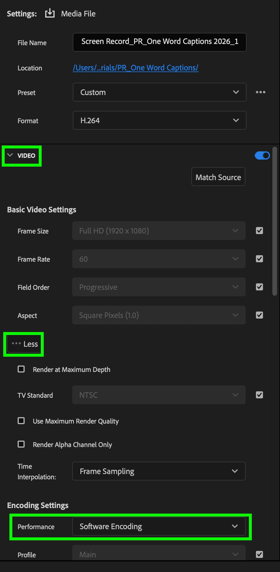

    Sorry for this frustration! Let's see how we can get your video over the finish line. Have you tried exporting to different locations on your computer? Are you exporting to an external hard drive, or is it somewhere local like your desktop?
    Does it share any error message? Feel free to share a screenshot of what happens when it crashes.
    You can also bypass the GPU entirely by switching to Software Encoding. See the screenshot to see where to access those settings in Export Mode.
    Let us know how it's going,
    Caroline
