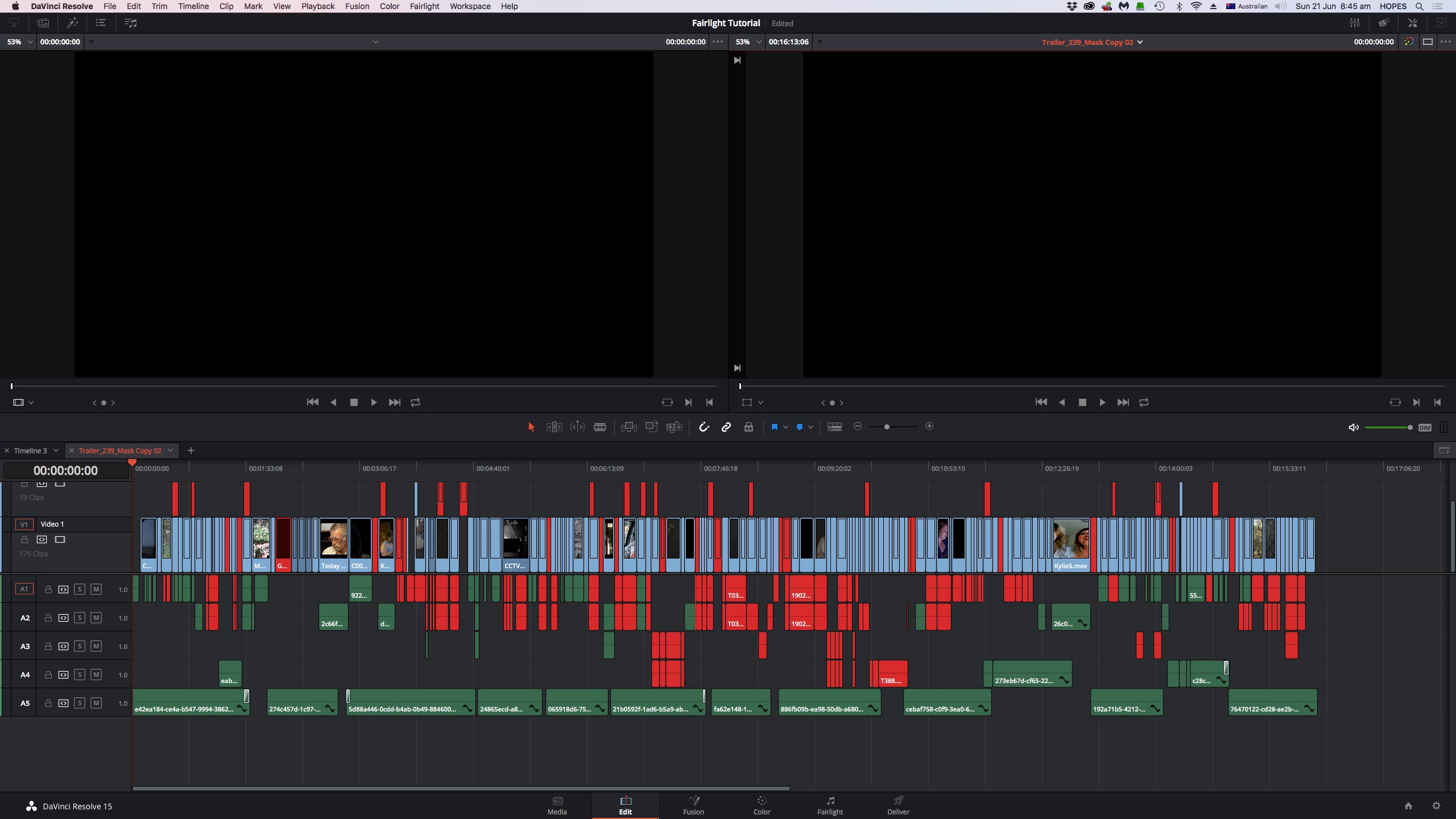

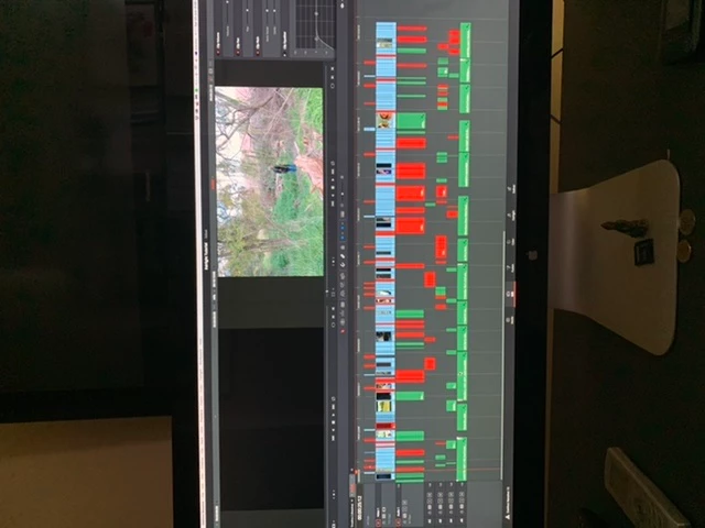

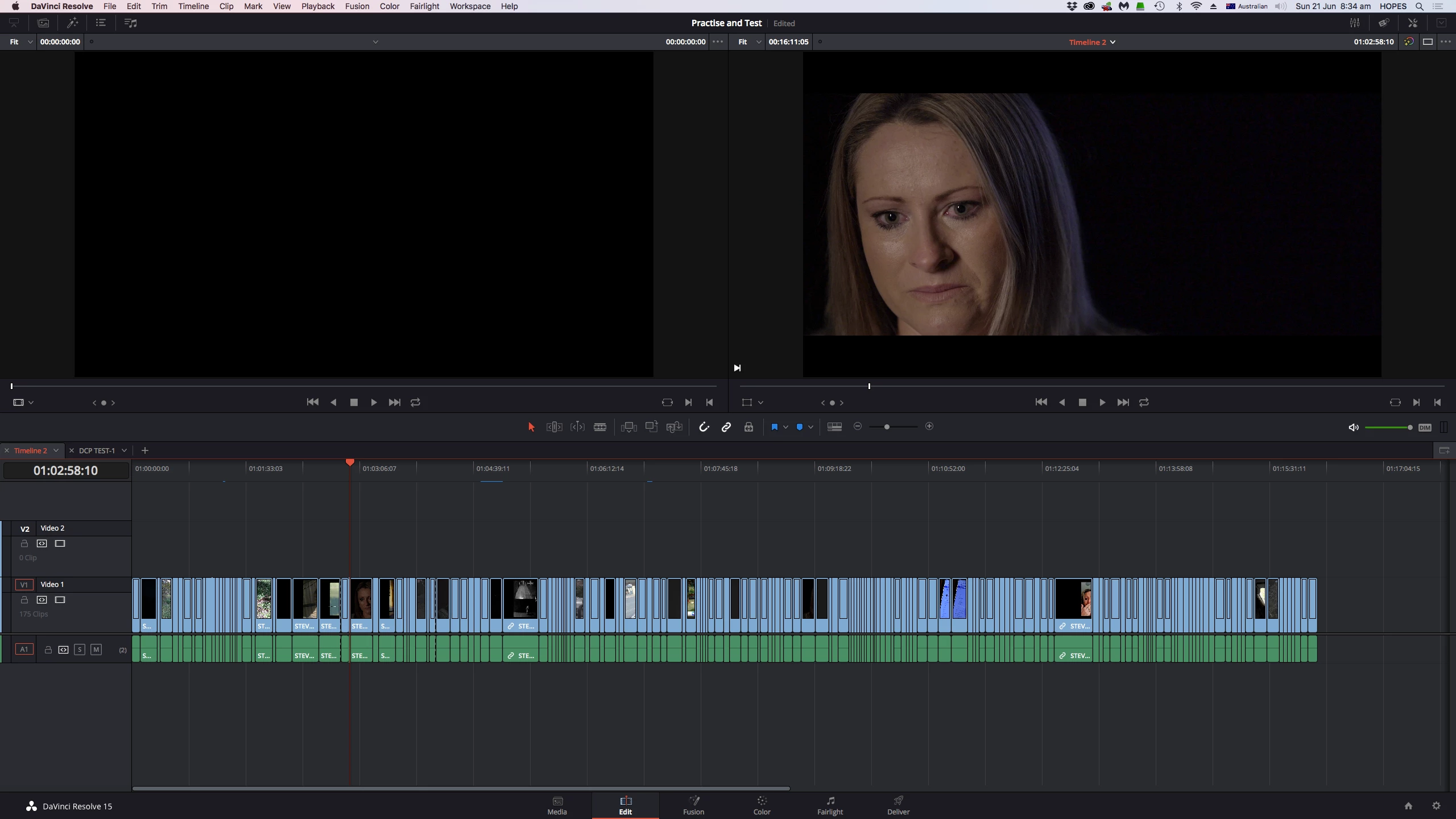

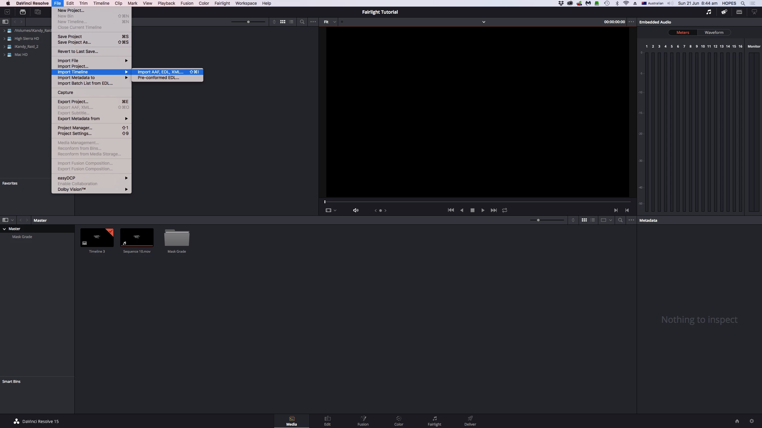

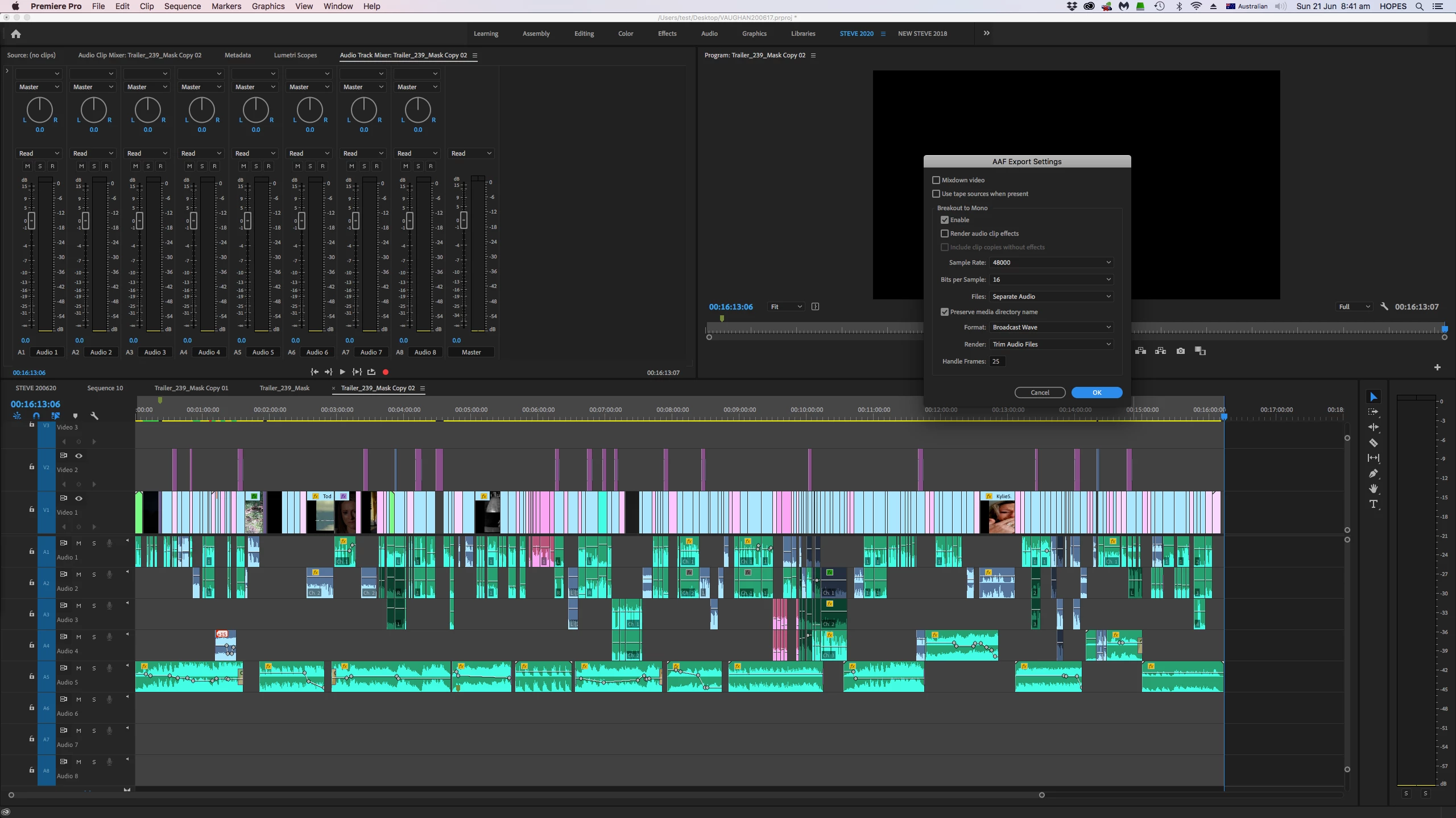

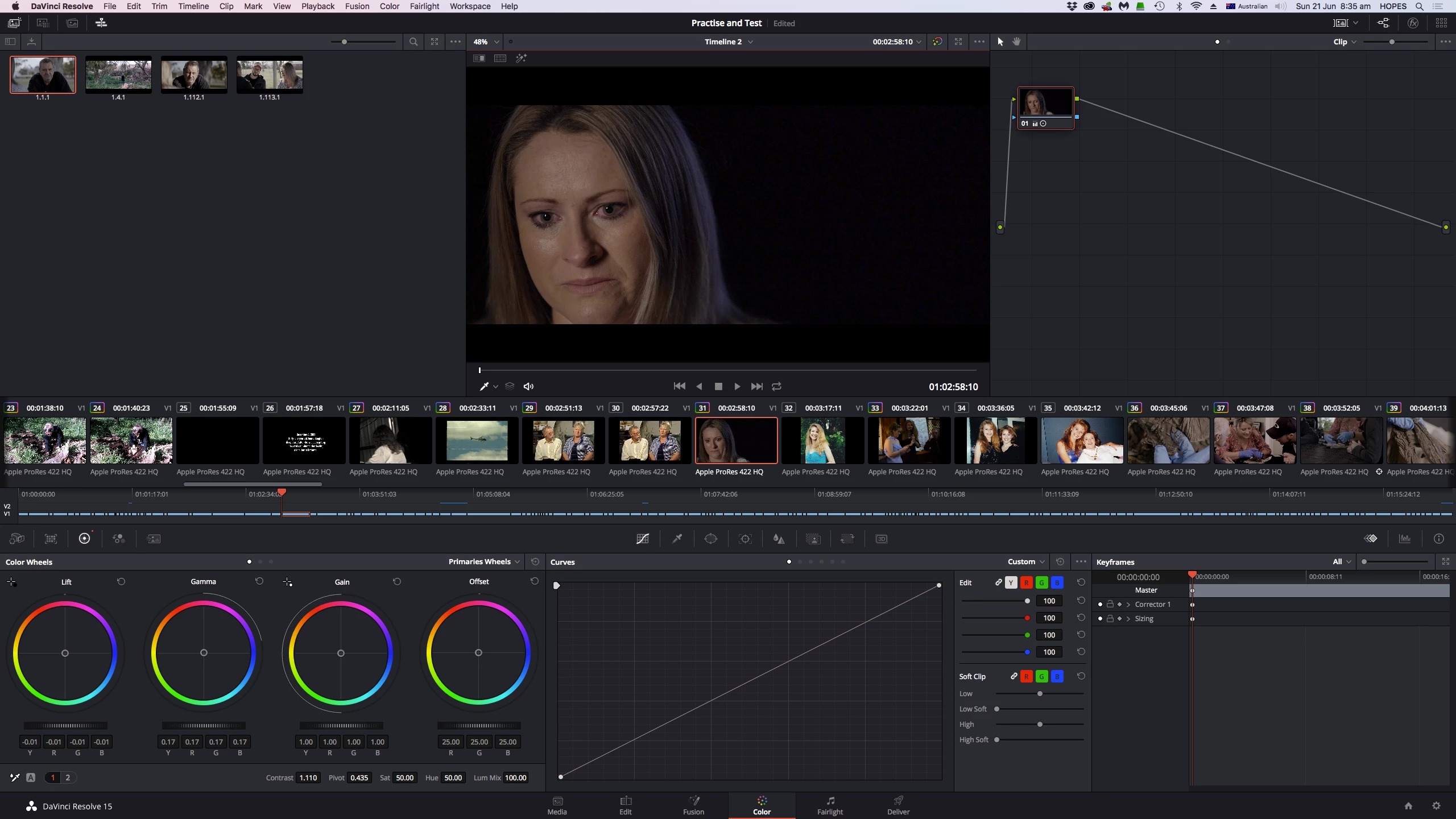

Jun 21, 2020 12:49 AM UTC
Hi neil,
Thanks for getting back to me. Yes you're right I should have taken the time to be more concise with my issue. Firstly I also have been delivering TV shows, long form theatrical documentaries to HBO BBC ABC here in Australia for many years with very little bother, typically for color I export a hires master (flattened to V1) with an EDL for the colorist to conform the timeline in Baselight or DaVinci which has worked every time and still does. The last few projects have been slightly different in that instead of OMF2 for audio we have been sending AAF's and again very little or no problems.
With this current project we have moved to 4K UHD aquisition due to a possible sale to Netflix where previously everything has either been SD or HD. Utilizing PP's proxy workflow for editing which has been brilliant. The proxies folder is next to the originals as per the PP default location for these.
We're using PP 14.3 which is the latest version and Resolve Studio 15.3... My best guess is that when exporting an XML or AAF from PP for an offsite DAW the pathways/directories are causing some linkage issues in the destination systems (this is definitely the case with Fairlight) OMF is no longer supported in Resolve so the only way around this for me has been to export audio stems from PP as stereo groups of VX, MX and SFX to be unpacked converted to mono and conformed in Fairlight... this is VERY time consuming however this is all that will work. I will attach some pics and once again maybe it is me but I'm not convinced it is.
