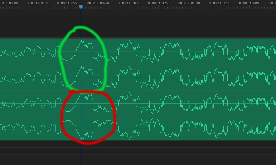

There are several ways. One of them is to locate where it happens on the timeline. Let´s say that the audio drops out between 00:00:30:00 and 00:00:40:00 one use the drop down menu on the timeline and can set it to Show Audio Time Units and zoom into the audio curves. If both audio curves point at the same direction, upwards in the attached image, it is in phase. If one curve point upwards and the other downwards the file are out of phase.

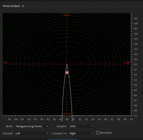

If it is as clear as this, open the file in Adobe Audition and go to Window > Phase Analysis. If the dot in the Phase Analysis panel is below the center line the audio is out of phase. Yet another way to confirm or rule out.
