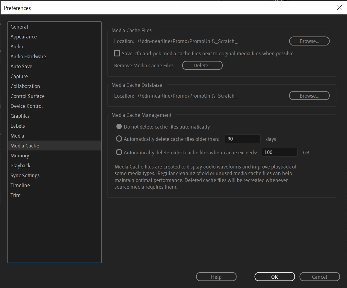

May 23, 2023
What about your media cache, is it also set to a drive with enough space?
The random timecodes where it's failing indicates that there shouldn't be anything wrong with your timeline, I'm just trying to figure out what might be causing the error.
