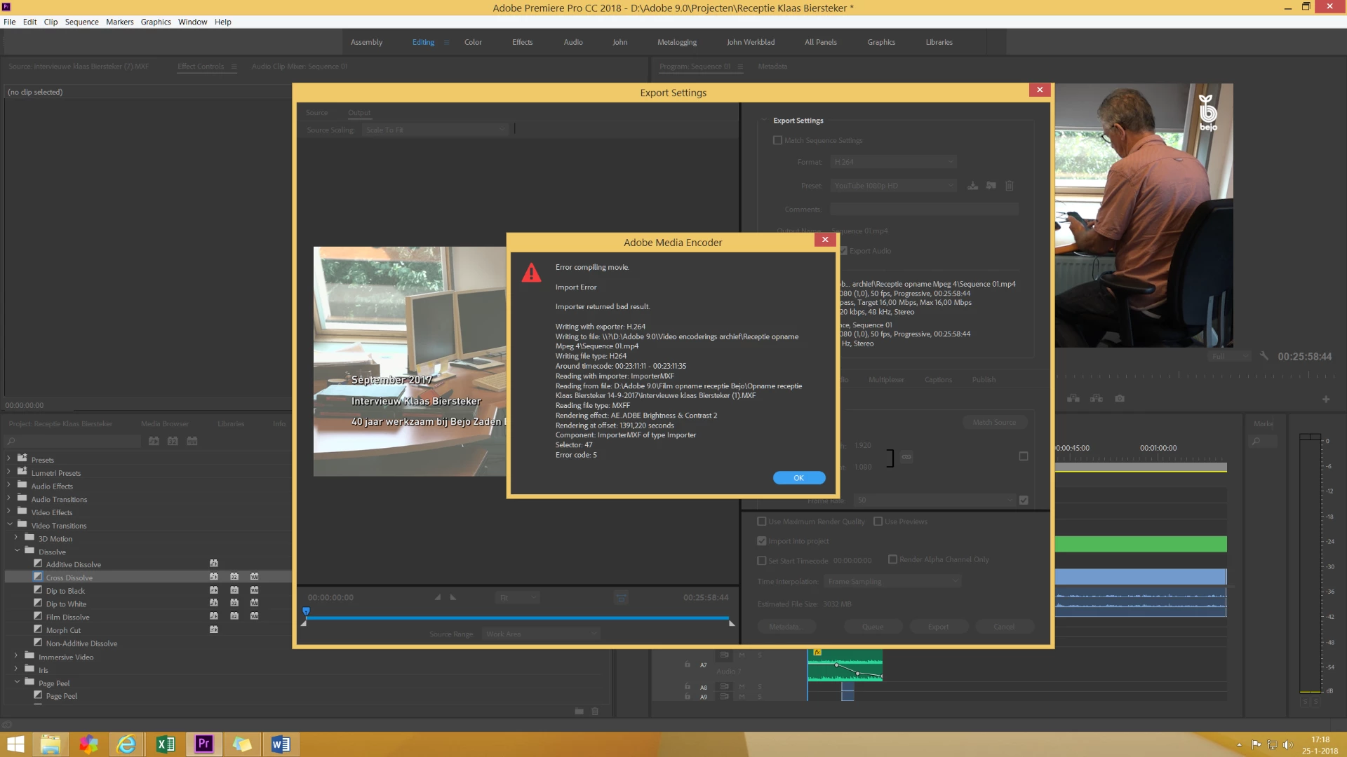

Januari I have updated premiere pro cc to; version 2018
Every time I try to make an export ill get an error at the same time pad, with Selector:47 and error code 5.
What do I do Wrong?
    Correct answer gerikp
    In your error box, it says something happened "Around timecode: 00:23:11:11 - 00:23:11:35"
    Go take a look at those frames and see what is there. Perhaps it's an effect, a third-party plugin, a photo, a font? Something at that timecode is causing the error.
    January 25, 2018
    Thanks for your answer. There was no picture or other graphic in the mentioned timecode. But I had an PSD logo on the total timeline from begining to the end of the timeline that gave the Error. And that was not what I had expected by the mening of the error. There was mentioned 00:23:11:11 - 00:23:11:35. By removing and replacing the logo everything worked well. Thanks.
