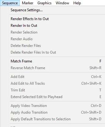

Hello Everyone.
Inside Sequence- Extend Selected Edit To Playhead is Dimmed out. When I press e nothing happens.
Thanks.
    Correct answer Horshack
    You need to have one of the ends of the clip selected in order for Premiere to know which one you want to extend to the playhead - click on an end so that it turns red, indicating that it's selected.

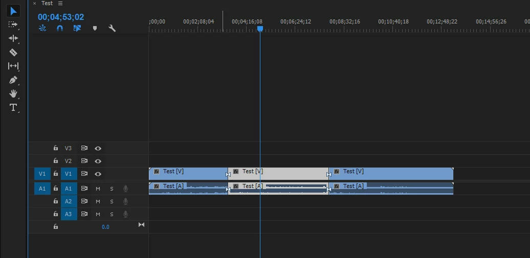

    Can you post a screen shot of your timeline, please?

    May 10, 2017
    Thank you very much.
    Horshack
    HorshackCorrect answer
    May 10, 2017
