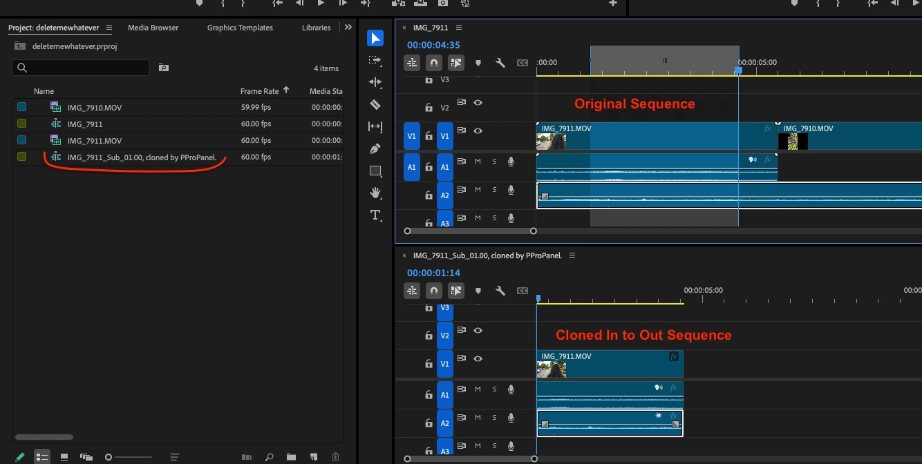

I ran a test where I set in to out points on a clip (ahem, trackItem) with multiple audio tracks. The result did have both audio tracks. Maybe double check that track targeting is on for all audio tracks?

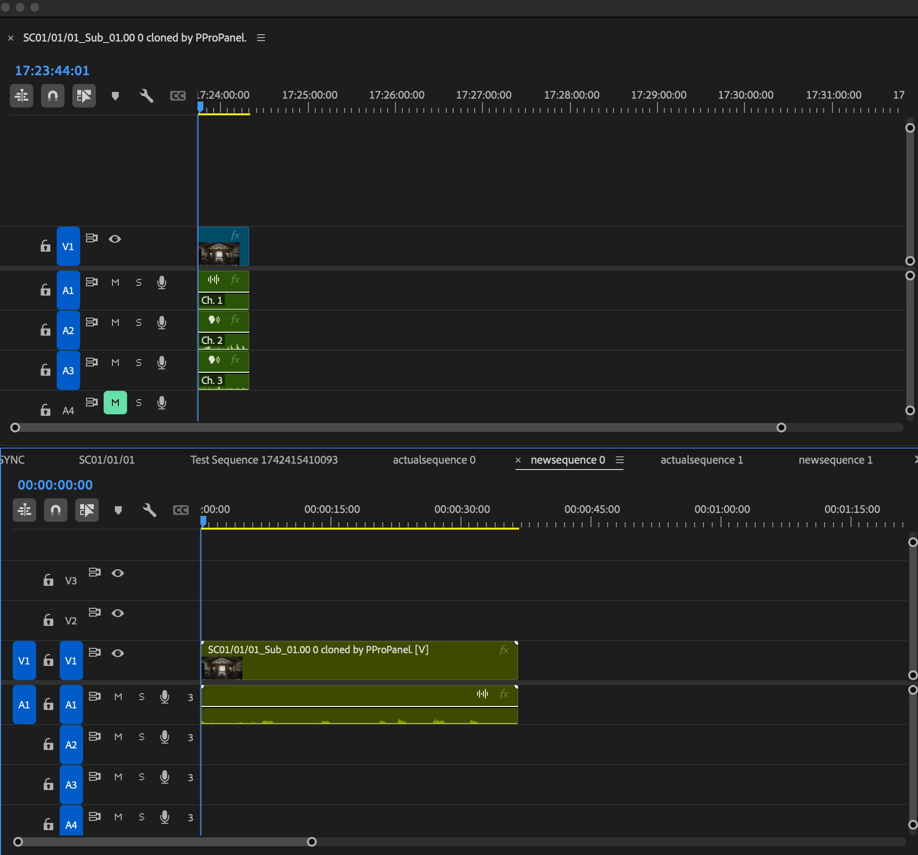

createNewSequenceFromClips method. When I try the below (with just one subsequence, newSequence), I only get 1 audio track in "newsequence 0" even though newSequence does have all 3 audio tracks:
var subsequenceProjectItem = newSequence.projectItem;
app.project.createNewSequenceFromClips("newsequence 0", subsequenceProjectItem)
Here's a screenshot of newSequence (which was created using createSubsequence), and the "newsequence 0" sequence that was created from newSequence's projectItem. My hope is to have many projectItems (each corresponding to a sequence created using createSubsequence) to be combined via app.project.createNewSequenceFromClips. Maybe this isn't the best way to do this?

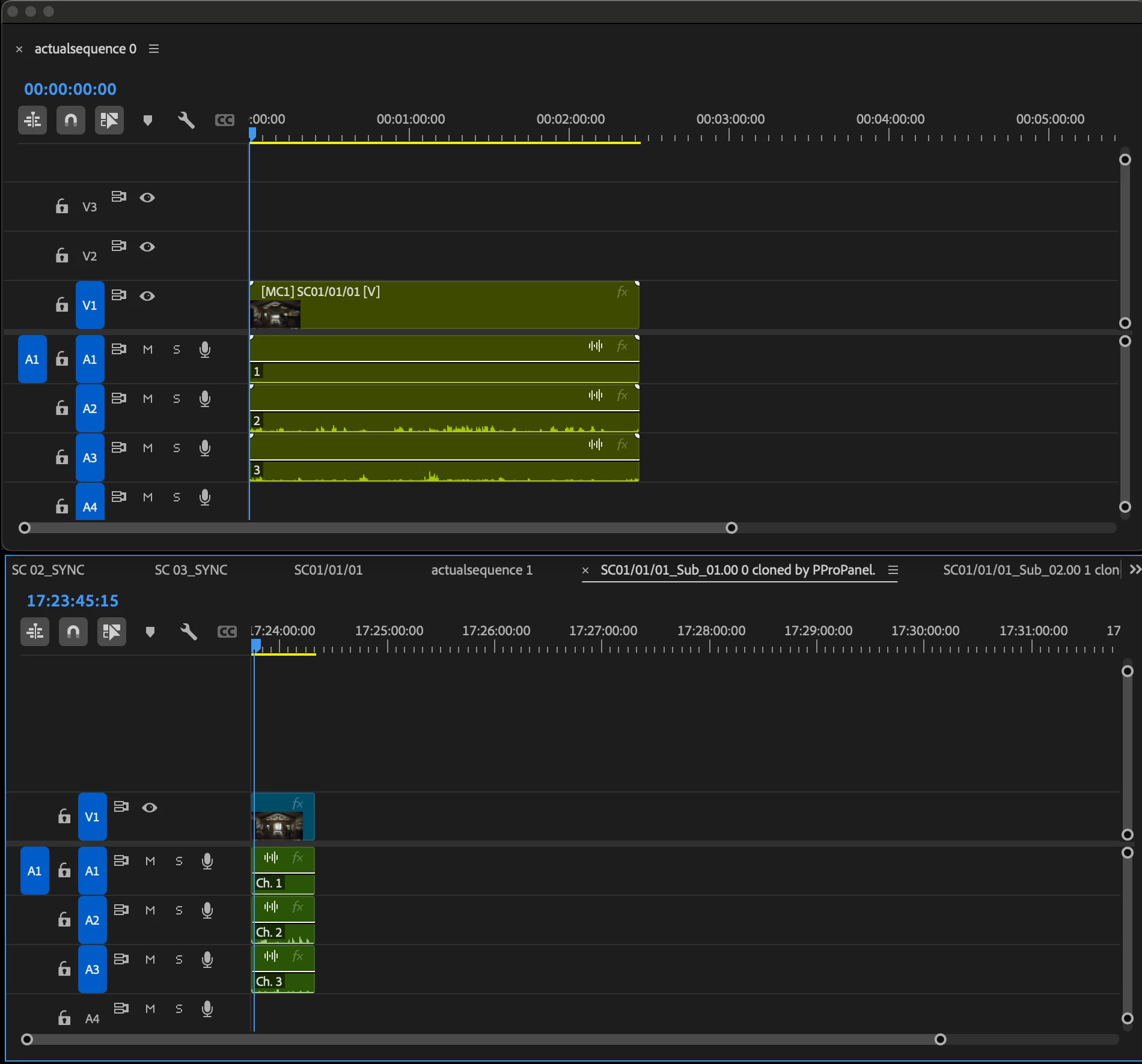

2. Another issue I'm seeing is that the actualSequence from which newSequence was created behaves a bit differently. When I play actualSequence, I hear audio track A3. But when I play newSequence, even though A3 is present, I do not hear it. Here's a screenshot of the two of them. None of the tracks are muted. The actualSequence clip is multicam so I'm not sure if that's the reason they look/behave different.

Your effort may be getting confused if one of the sequences is multicam. If you make a subsequence from multicam, it will only use the active camera - and there is no support in extendscript for this.
