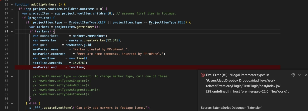

I'm experementing with setting clip markers (As in this example). I'm able to set the marker but when trying to set the endtime for the marker I get a parameter error although the type of the parameter is right(Time).
What is wrong here?
The offending line (As in the example):
newMarker.end			= tempTime;
I get :
Eval Error (#1): "Illegal Parameter type" in '/Work related/Premiere/Plugin/FirstPlugin/host/index.jsx' [29:undefined] in host 'premierepro-22.0 (NewWorld)'.
This is how it looks in the VS code:
Seems like its premiere pro 22.0 (not sure what other versions to check)
Correct answer Bruce Bullis
Good news: It turns out it was the sample code*, not the API, that was the problem.
This works:
var activeSequence = app.project.activeSequence;
if (activeSequence) {
    var markers = activeSequence.markers;
    if (markers){
        var newCommentMarker		= markers.createMarker(12.345);
        newCommentMarker.end            = (newCommentMarker.start.seconds + 5.0);
* Yeah, it was my sample code. 🙂
This works:
    if (markers){
