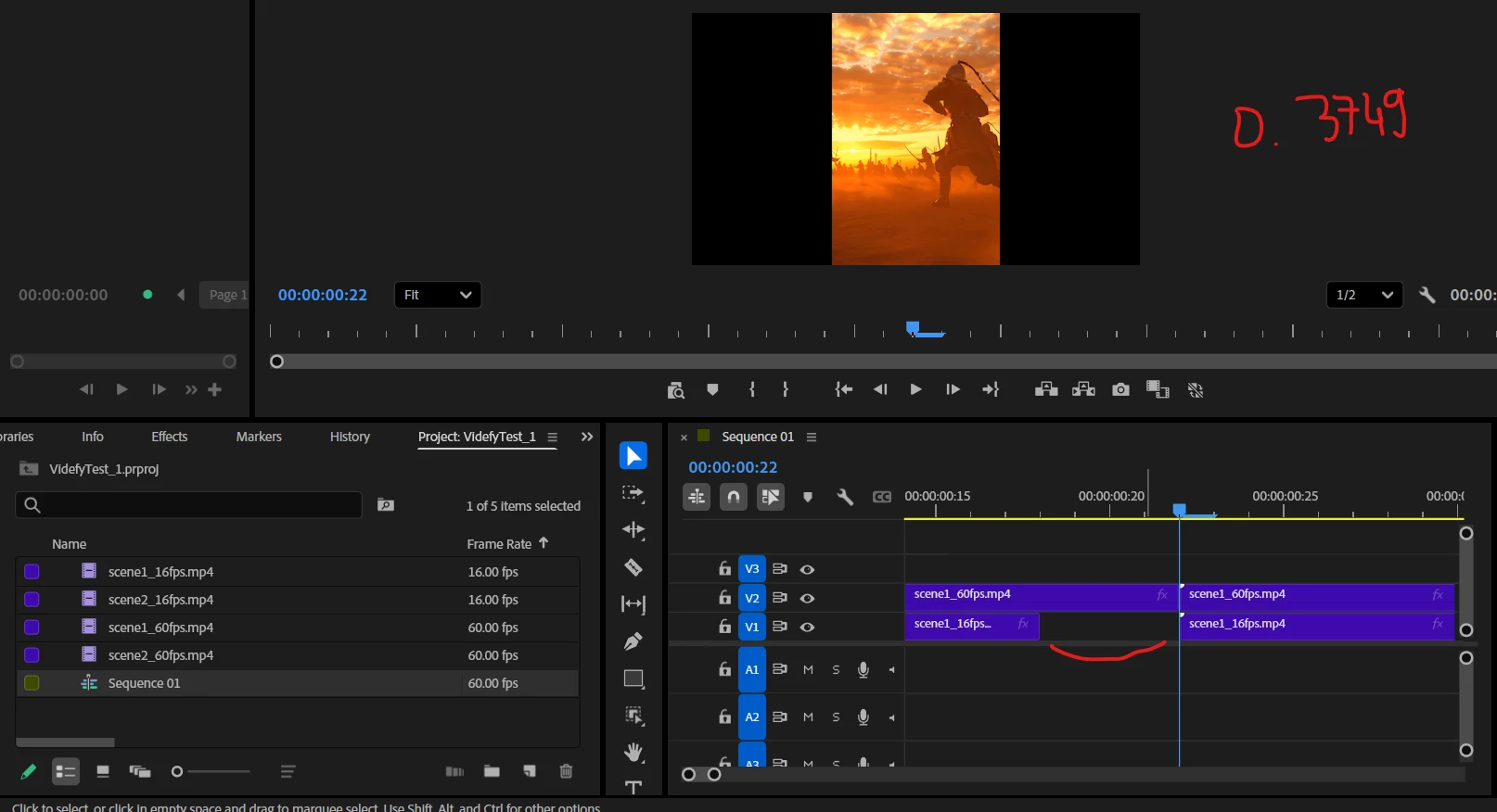

    var time = new Time()
    var targetSeconds = 0.3749
    //var targetSeconds = 0.38;
    var targetTicks = targetSeconds * 254016000000;
    time.ticks = targetTicks.toString()
    scene1_16fps_item.setOutPoint(time, 1)
    var newClip11 = track.insertClip(scene1_16fps_item, 0);
    scene1_60fps_item.setOutPoint(time, 1)
    var newClip21 = track2.insertClip(scene1_60fps_item, 0);
    var newClip12 = track.insertClip(scene1_16fps_item, time);
    var newClip22 = track2.insertClip(scene1_60fps_item, time);
    What it does: places the first clip scene1 starting at frame 0, cut at 0.3749s. Then places the next two clips at the same time offset.
  4. Expected behavior: first clip ends at 0.3749 × 60 = 22.494 ≈ 22 frames. Next clip starts immediately after.
    Actual behavior: 60 fps clips are placed correctly; 16 fps clip has a gap of 4 (!) frames.

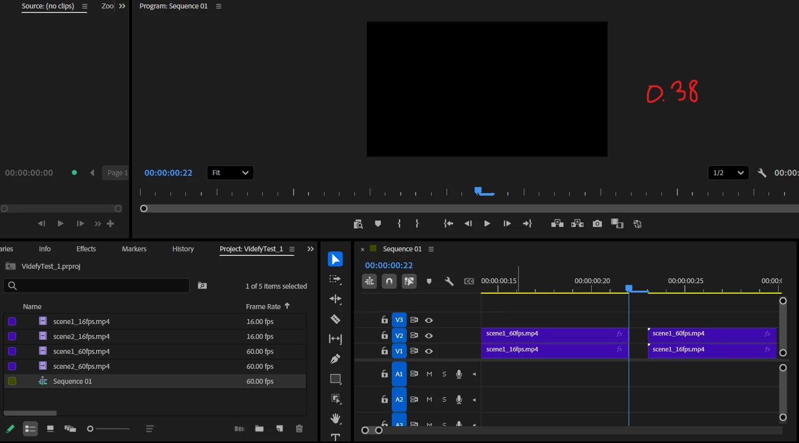

    time = 0.3749s
  5. You can change the value to 0.38 and see that both first clips end at frame 22 and both second clips start one frame later - which is also incorrect.
    time = 0.38s
