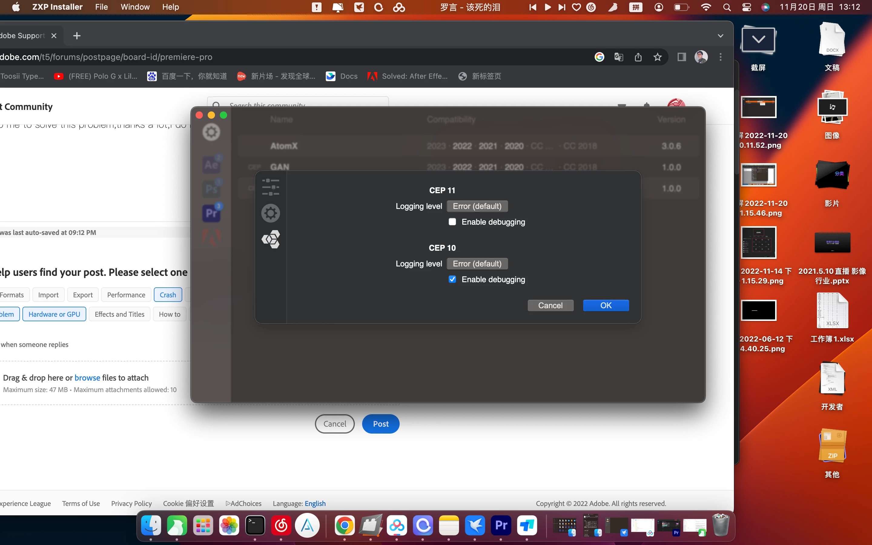

my extensions can not open in the Macos,i pack it with a dmg,but i found when i use zxp installer to set CEP 11 enable debugging,it works and it only work in this mode of my mac.But still some mac is blank when i open my extensions,but i have no more mac to test,maybe you can help me to solve this problem,thanks a lot,i do not know what happened.

You might try signing with a different time server, but the fact that the panel loads when unsigned panels are enabled, but not when unsigned panels are dis-abled, suggests problems with the signing.
If you see the failure on MacOS X 12.x, then that rules out the additional application security added by MacOS X 13.x.

If your extension works with debugging enabled, then your extension is not signed correctly.

this is zxp intaller log,i don‘t know if it will help:
[1120/010144.191345:ERROR:ssl_client_socket_impl.cc(946)] handshake failed; returned -1, SSL error code 1, net_error -100
[1120/010145.120067:ERROR:ssl_client_socket_impl.cc(946)] handshake failed; returned -1, SSL error code 1, net_error -100
