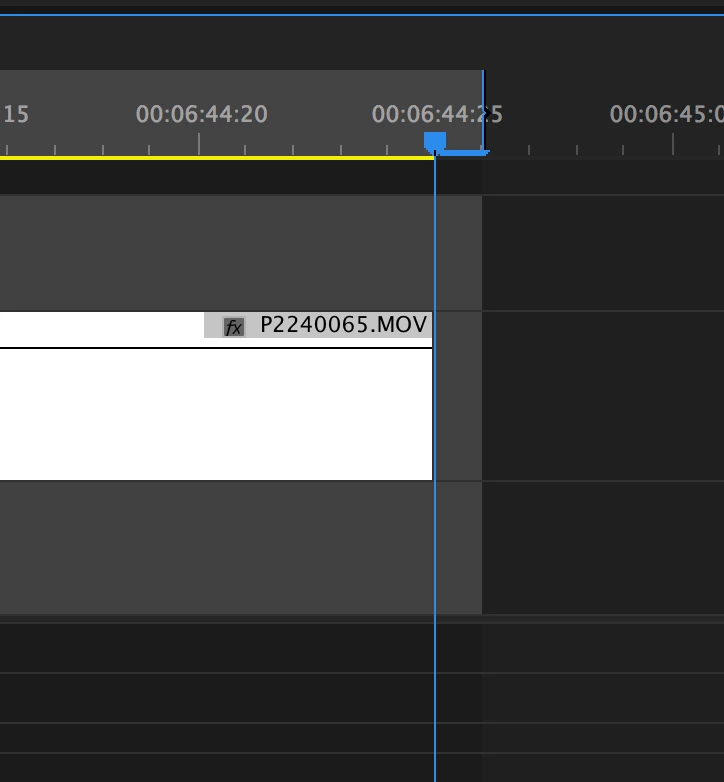

extra frame when exporting media using in / out points
using in and out points to select a clip to export and it automattically selects an additional frame in front of the play head on the out point - very frustrating .
is there a setting to change preference so that my in and out points define the EXACT in and out that i want to export ?
my exported clips are to be looped so the additional frames are a problem.

R Neil Haugen
Mar 6, 2021 12:58 AM UTC
Like Kevin says, this can be a bummer.
The main thing is remembering to use the Mark Clip command if you have the clips selected. And if not, then use the down-arrow to get to the end and immediately hit the left arrow to move the CTI back one frame.
There's also a couple other keyboard shorts you can set ... "go to selected clip end" one of them.
Like anything else, everyone gets around this annoying part of editing differently.
Neil

Kevin J. Monahan Jr.
Mar 5, 2021 11:53 PM UTC
Hey there, Russ. That's the way most NLEs work by default. Glad you discovered that one. The playhead has a head and a tail that is out of view unless you zoom far into the Timeline.
Here's the trick: If you use the playhead to mark Out, then this happens. You always have to move left one frame, then, mark Out. If you're just discovering this now, think of all the extra frames you've removed off the head of every incoming clip you've ever used the playhead you marked Out on. Egads, I know. The horror.
Media Composer addresses this by offering a toggle to override this behavior and set the Out mark where the head of the playhead lies, so I think your request is certainly valid. That would make a great feature request for the devs to see here (we are only the support crew here): https://adobe-video.uservoice.com/forums/911233-premiere-pro
Personally, I use the Mark Clip command when marking the In and Out for a clip which sets the Mark Out properly, and as you expect instead. Please try that function and use it often. It works perfectly for just what you want to do.
