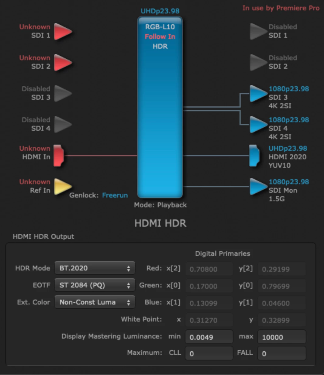

R Neil Haugen
Nov 22, 2019 1:13 AM UTC
I have a response from an Adobe color engineer, and I hope this is of help:
Lumetri doesn't influence the export over Transmit.
The place to go is to Preferences > Playback > AJA > Setup.
In the AJA Setup menu select HDR > Rec. 2020 PQ. This setting overrides the setting in the standalone AJA Control Panel, when playing.
If your image width is above 2K you might exceed the supported AJA or HDMI data rates. If so, select AJA Control Panel instead of Sequence setting. And select a 1080 option in the standalone AJA Control Panel's Format panel.
In the Preferences > Playback panel check Enable Mercury Transmit (It's also an option in the program monitor tool menu)
And if you have other apps using AJA (such as After Effects), do select the last option: Disable video output when in background.
This is also documented in the AJA documentation for Premiere.
Everyone's mileage always varies ...
R Neil Haugen
Nov 21, 2019 7:26 PM UTC
As that is showing HDMI input, I'm assuming you are on a Mac, and running the io4k or io4k+ unit?
Neil
Nov 21, 2019 8:07 PM UTC
Yes, the AJA io4k
R Neil Haugen
Nov 21, 2019 6:41 PM UTC
I've had a few HDR clips/media on my system, and the scopes when set to the Rec.2020 color space in the Scopes panel (right-click) ... showed the media correctly.
Of course, none of the Premiere's monitors can. They all show any HDR media with clipped whites around 103IRE or so, and at times crushed blacks. Whether Program, Transmit Out, Source, or Reference.
That's why the Aja kit ... the Kona 4/5 PCIe cards for the PC, or the io4K for the Mac ... are required.
It sounds like in your system, it's getting the internal monitors output ... rather than the Premiere HDR signal, somehow. Make sure Transmit Out is disabled in Premiere.
And just to check ... which AJA piece are you using? Can you create a screen-grab of the settings for that and use the picture icon to upload it to your reply?
Neil
Nov 21, 2019 7:03 PM UTC
