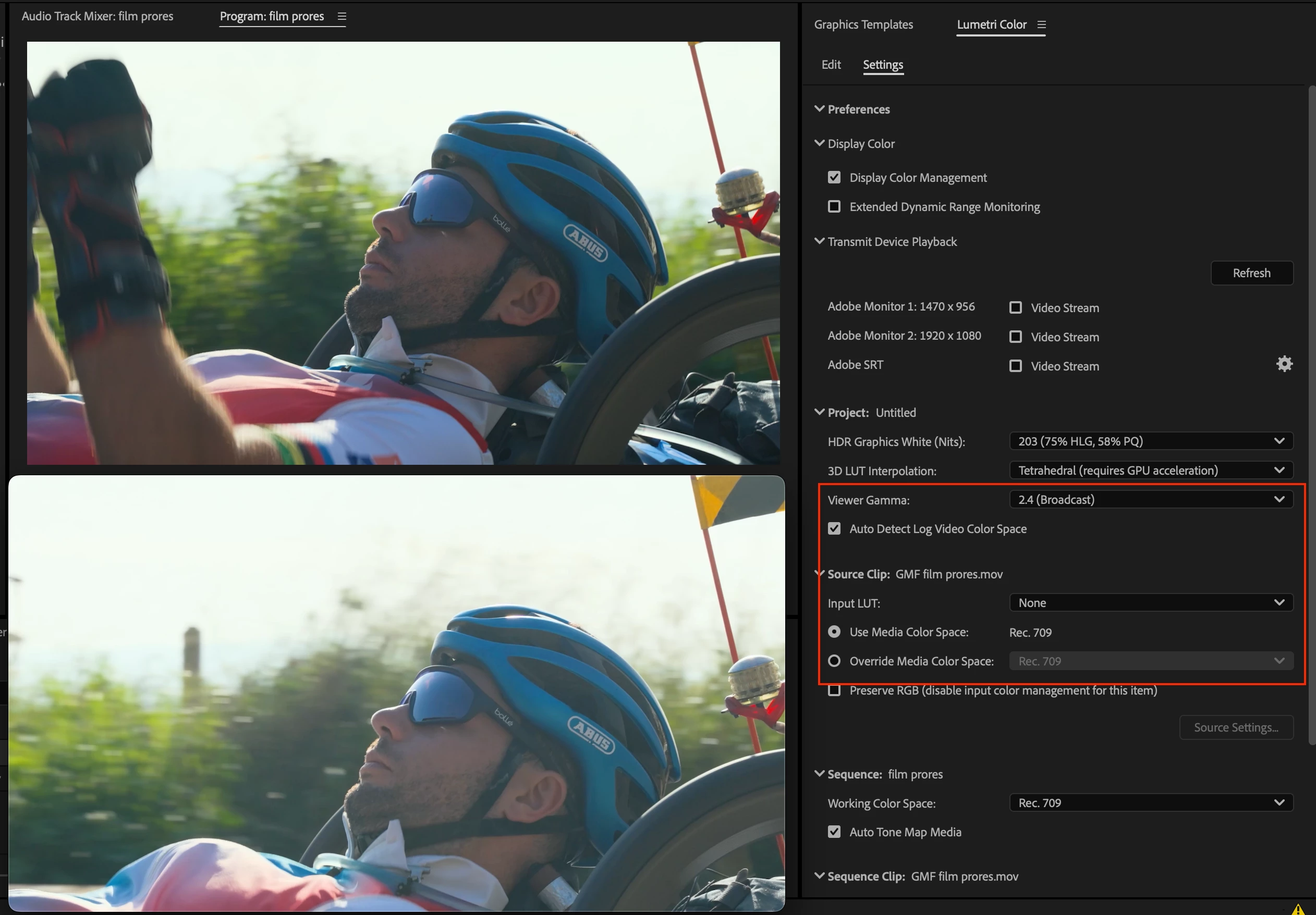

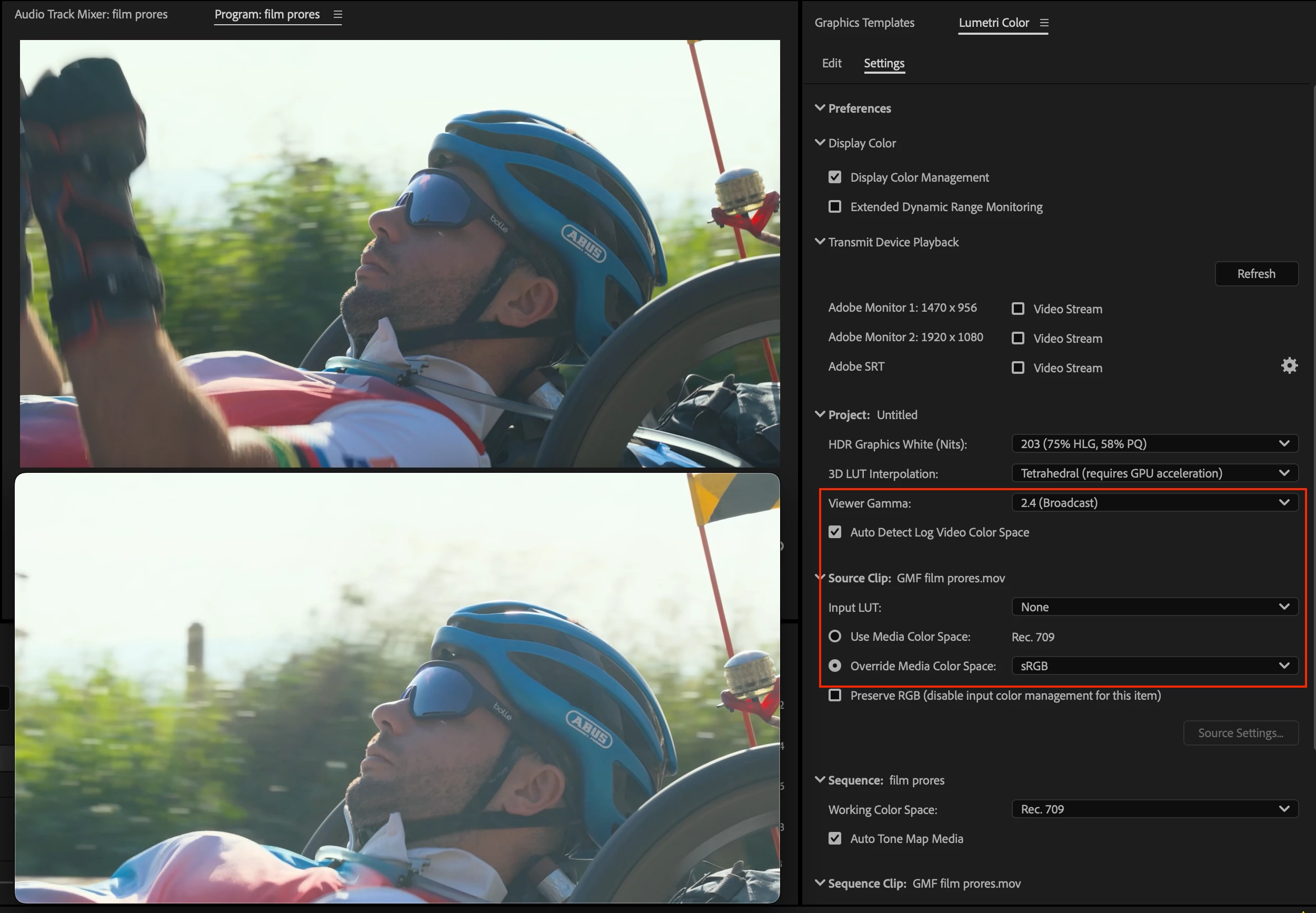

I'm french so excuse my english please.
There's something that I really don't understand with viewer gamma option. See images below, they show my premiere settings, also the program monitor (upper image) and the quicktime look after export (lower image).
I've made 4 tests with the same shot, changing the viewer gamma and also the media color space setting.
As you can see, when the "source clip" section is set to "use media color space", then "viewer gamma" 2.4 or 1.96 change the look of images inside premiere's display but does not affect the exported file. BUT, if for some reason we want to override media color space of the clip (here set to sRGB instead of rec709) then we get in the reverse situation : changing "viewer gamma" from 2.4 to 1.96 won't do anything in premiere display, but the exported files will be different.
It seems like overriding color space of the media is applied after the gamma viewer correction, wich is very weird logic to me.
Am I missing something ?
