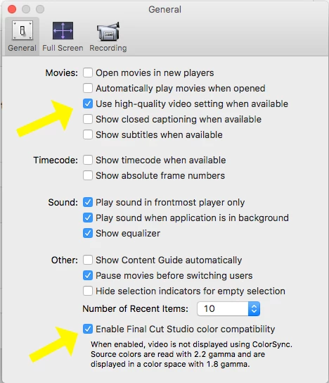

    Do you have QuickTime Player 7 on your computer? If would be in Applications > Utilities  folder.
    If so, launch it and set the Preferences to Use High Quality Video setting when available and Enable Final Cut Studio color compatibility:
    and try playing it in QT7.
