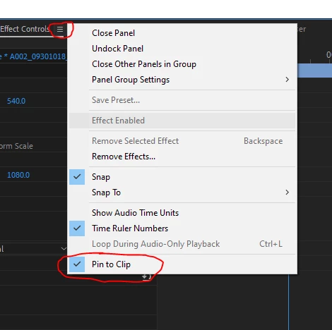

How do I extend the effect control panel to find keyframes when I copy/paste an effect onto a new clip, but the new effect is longer than the new clip and it has cut off part of the keyframes so I can readjust the effect?
IE
Fade in/out is starts at 0 ends at 5 seconds. but clip is 3 seconds. It will cut the fade out effect, or part of it. Is there a way to view the fade out part to bring it within the 3 second timeline/ View the 5 second effect and scale the last part back into the clip?
Correct answer Richard M Knight
This option often helps with 'out of shot' keyframes:
Richard M KnightCommunity ExpertCorrect answer
December 9, 2020
December 9, 2020
Thank you, that was what I was looking for. Its been a problem for me for awhile! I thought it just cut it off permently.

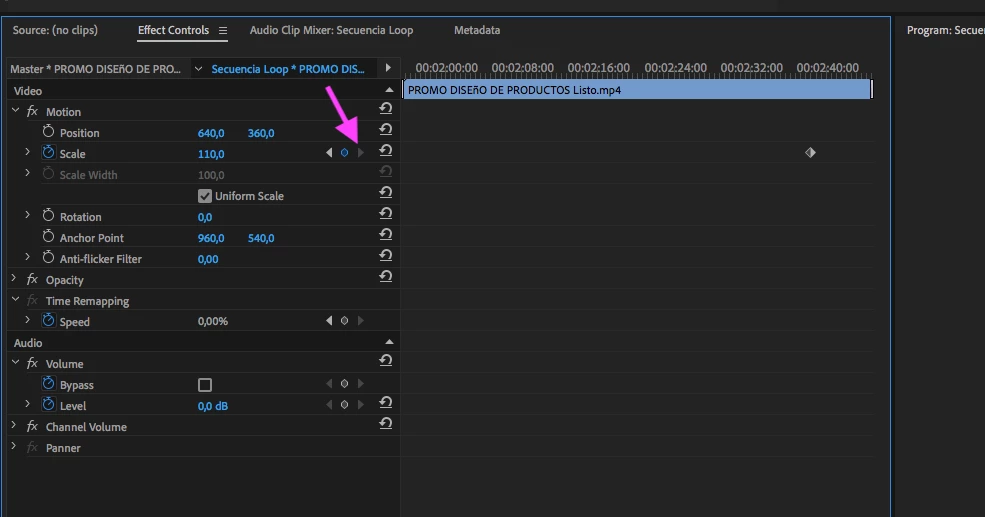

You can move to its location with this button in the effect applied and there modify it, but I don't think you can bring it back. At least I don't know of an option.
Byron.
December 9, 2020
If that keyframe was at say... 3:00:00, you couldnt see it. The arrow would hit a wall at 2:40:00 on the right side, or just not move from the current keyframe. As far as I know? I was hoping there was a way to extend the window further  to the right to reveal the hidden keyframes 😞
