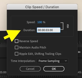

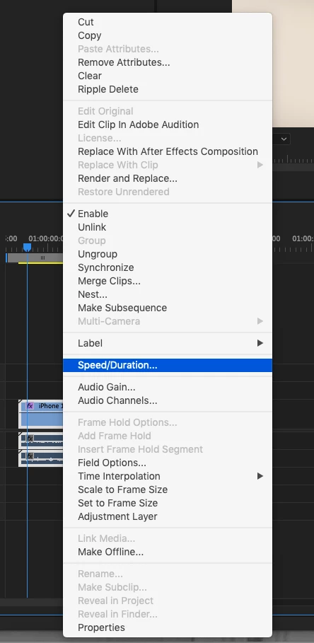

    March 11, 2019
    You can right-click on the clip that is your PIP and from the drop down menu choose Speed/Duration, and set the duration for the clip in the pane that opens.
