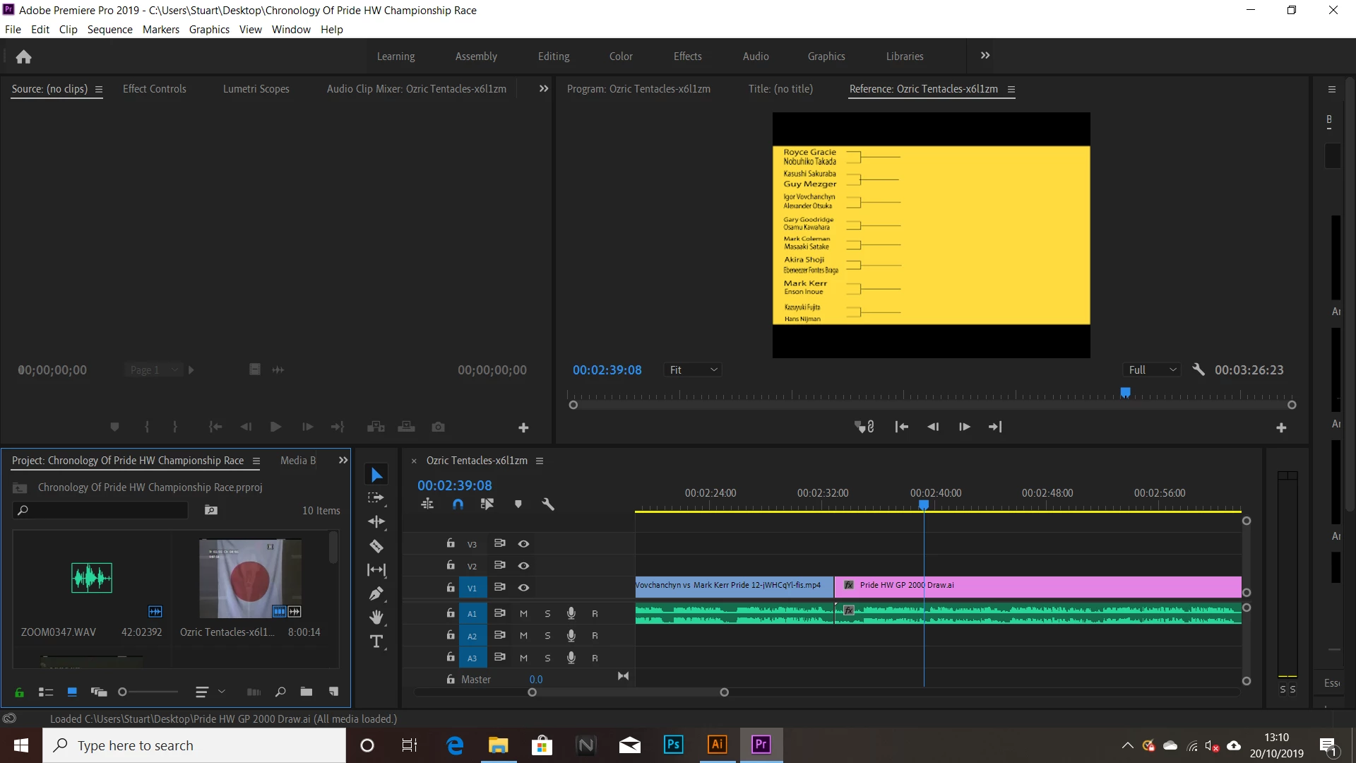

I have edited a slide on Adobe illustrator which I have imported into the project.
When I double click on the source monitor tab, it displays as full size and fits to screen.
When I import it onto the timeline and play in the program monitor it cuts off the top and bottom and displays them as blank as it the original document was too landscape to fit on the screen. Kind of like trying to fit a rectangle into a square.

    Do you see from panel in the top right that it's cutting off the top and bottom of the slide?

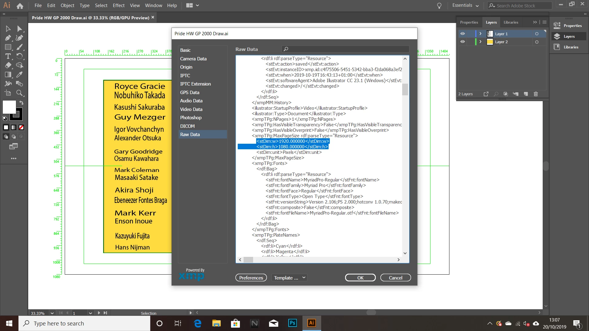

    I thought I selected 1920X1080 when I opened the slide, the highlighted section of the raw data screenshot seems to support that.
