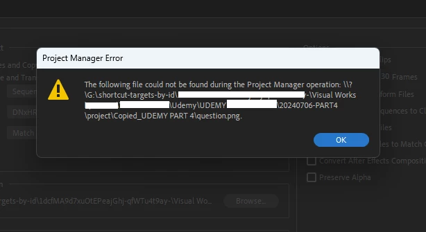

Everytime I'm attempting to backup the Premiere Pro project for transfer I'm receiveing this error that reads:
"The following file could not be found during the Project Manager operation: \\?\C:\Users\myusername\Desktop etc etc"
I've no idea what's causing this as the file works perfectly in my timeline and I'm desperate to get this project collected so I can share it with my team. What the heck is going on?

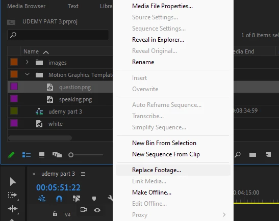

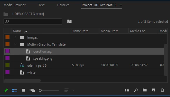

I had the same issue with the contents that I use in my Essential Graphics which I made using an image named "question.png". Every time I wanted to back up my project via Project Manager, it gave me the same error saying that the file could not be found during the operation, even though it worked perfectly in the project or during rendering process. I located the file in the Project Panel where we import and list the files that we use in the project, and right-clicked it to replace the footage. I reconnected the files through these steps and it worked for me.

Project Manager won't push through with consolidation after seeing the error. So no files are copied over by Premiere. This is not the correct answer
