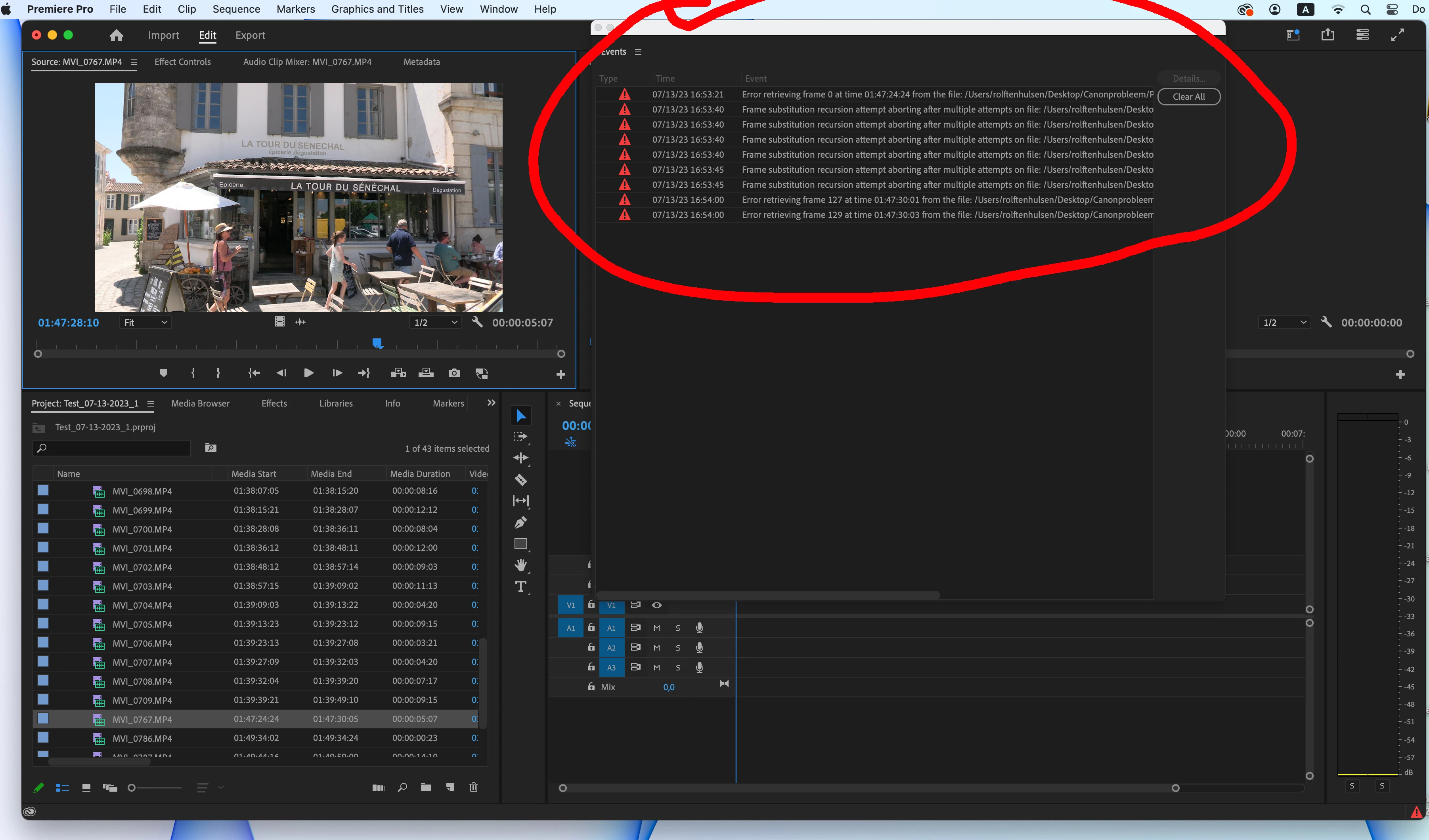

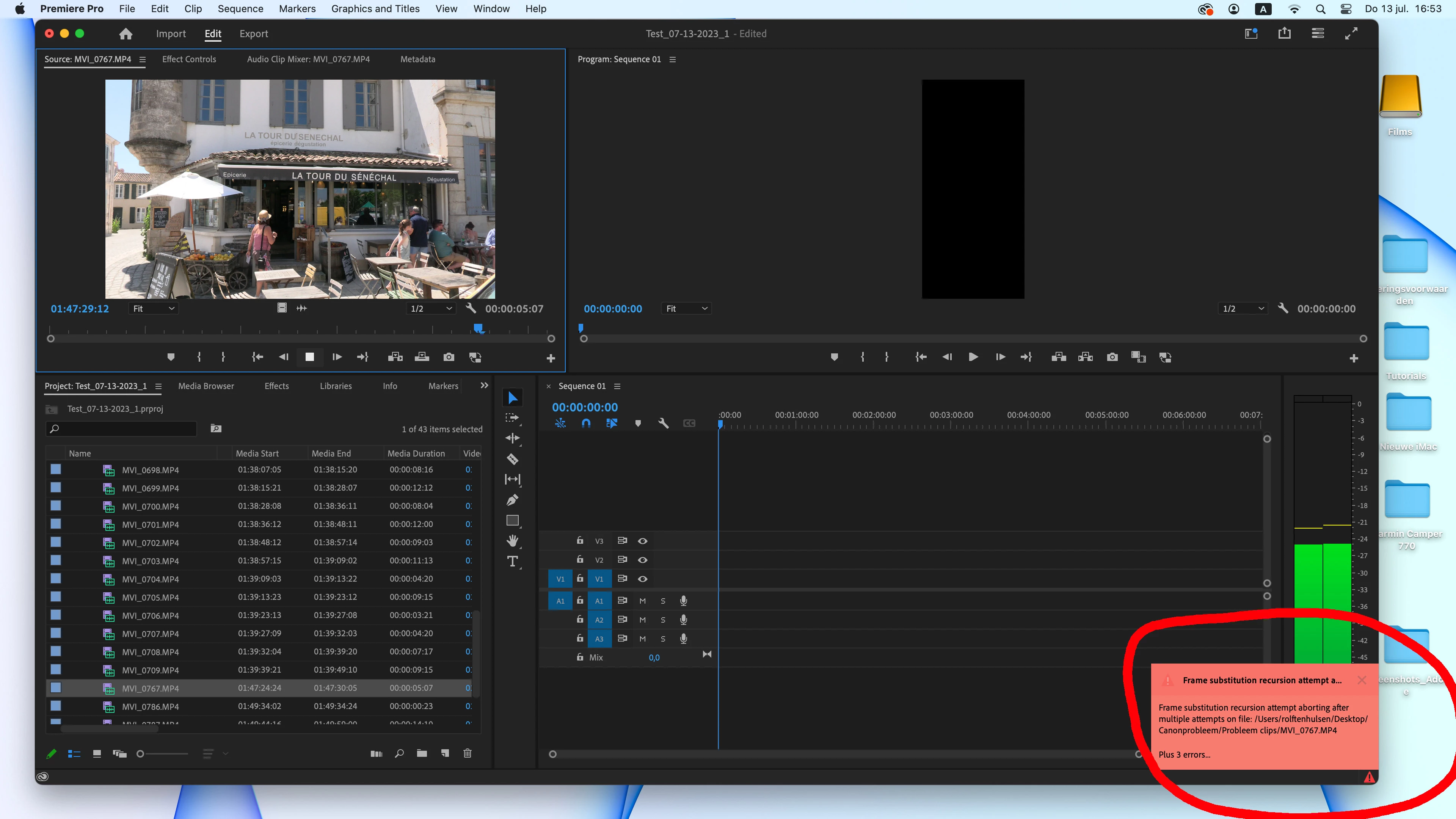

I played the clip a couple of times and I get the same error: not Retrieving frames. Program monitor turns black.

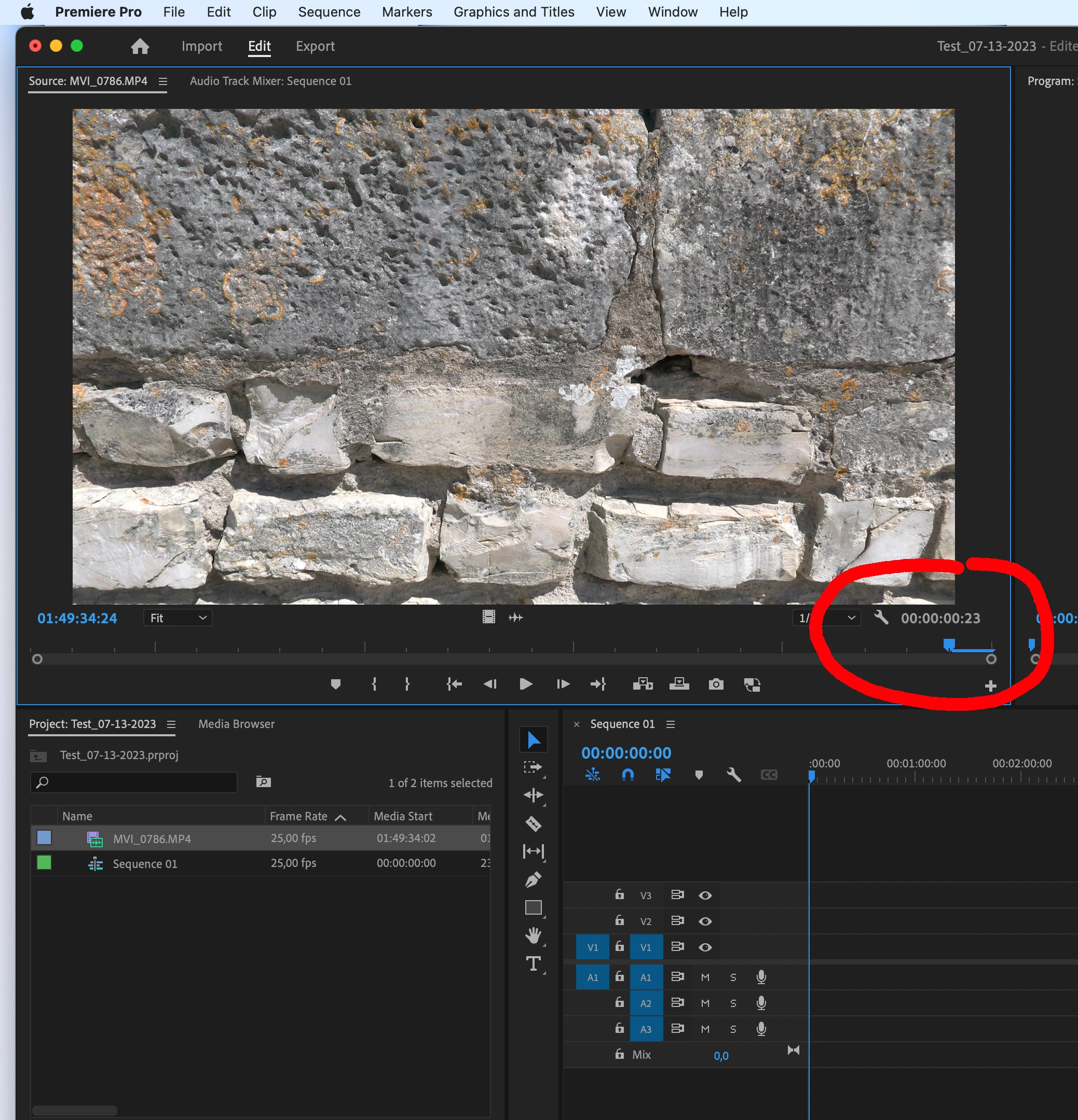

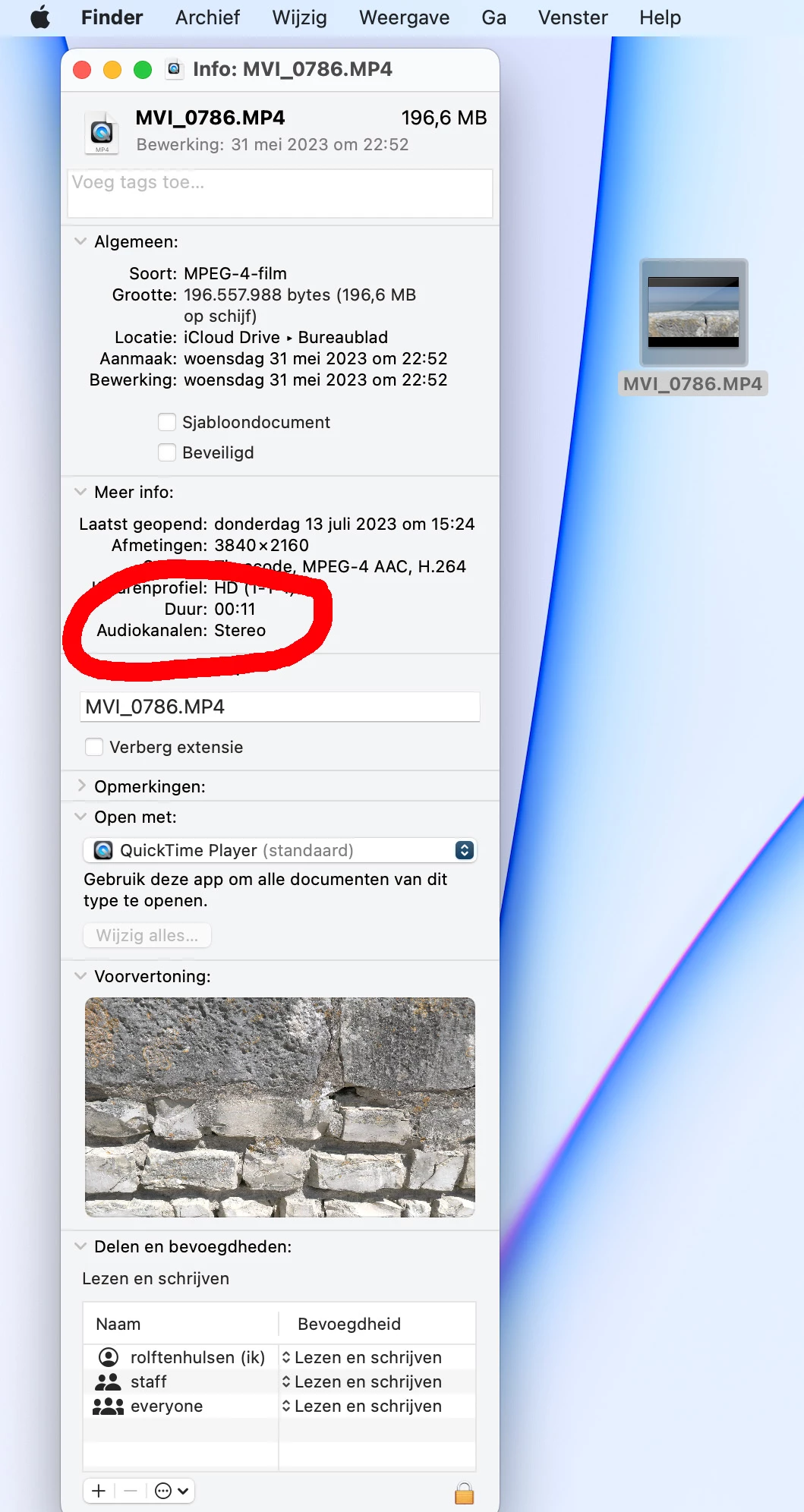

I made some extra screenshots to show the problem. The clips looks fine in Quicktime but just shows 23 frames in Premiere...
Does omebody know how it is possible that the clip plays completely with Quicktime, but once I import it into Premiere Pro only a fraction? Thanks!
