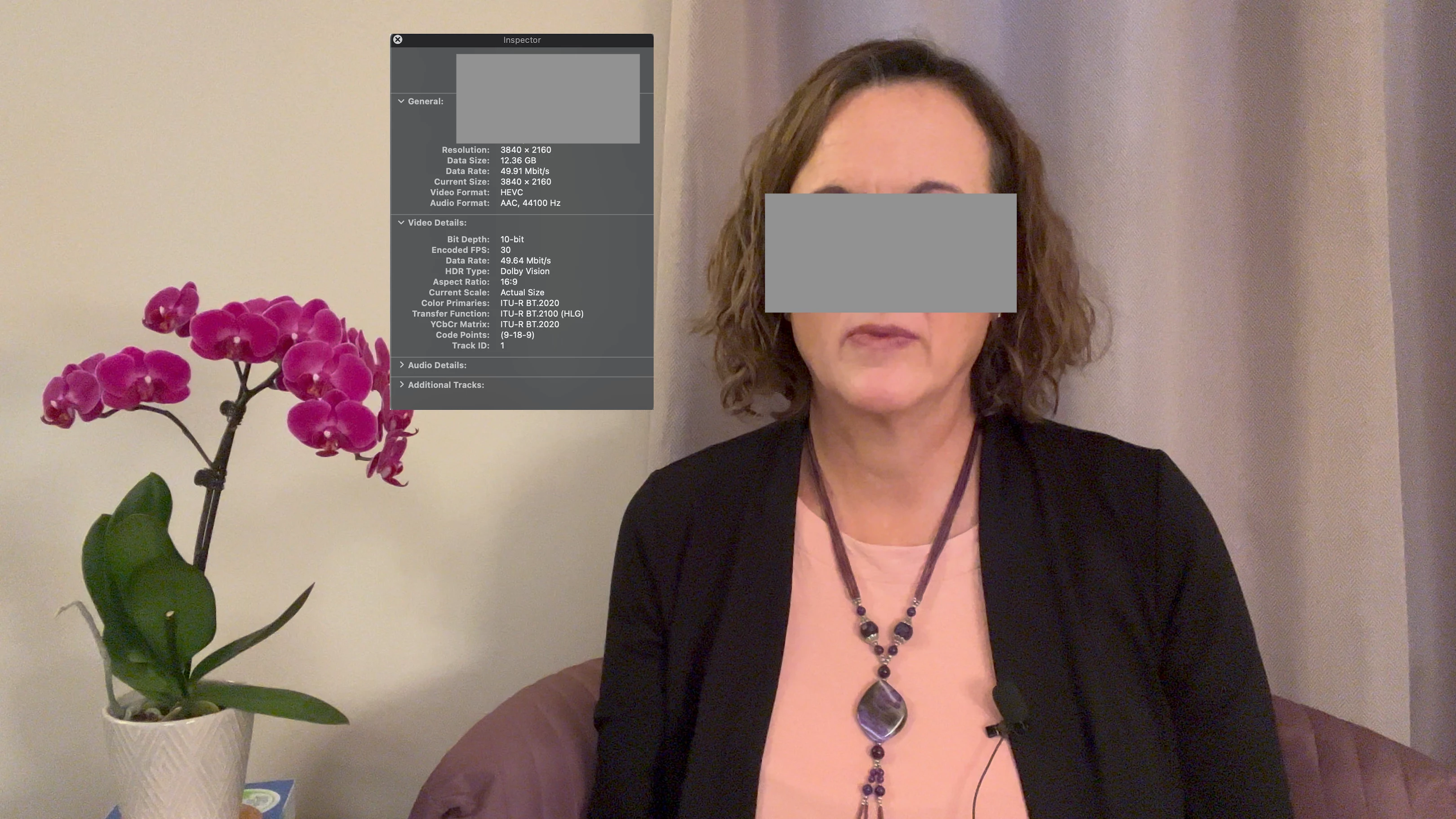

Here is the original file in QT with the QT Inspector Window to show info about the original file:

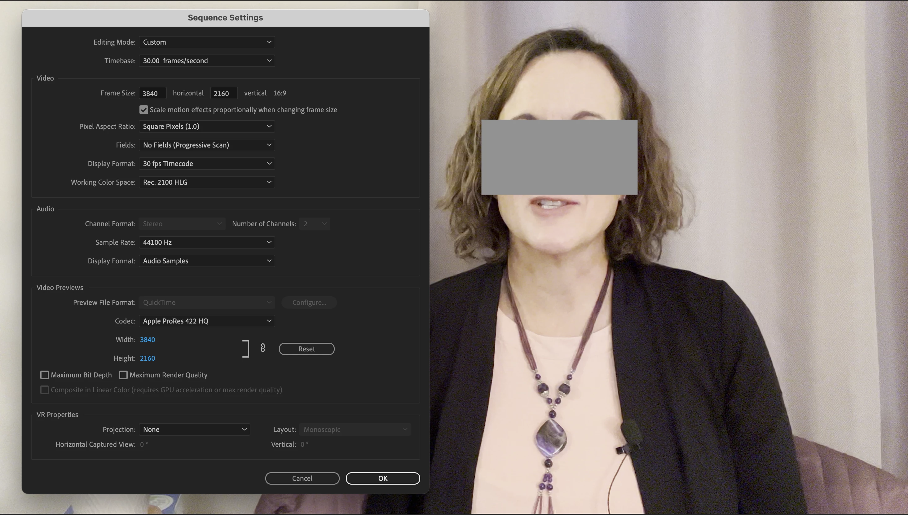

Here is the file Imported into Premeire, a sequence made from the imported MOV file, with the Sequence Settings displayed. No adjustments have been made, this is just a sequence made from the imported file above, and it looks quite different.:

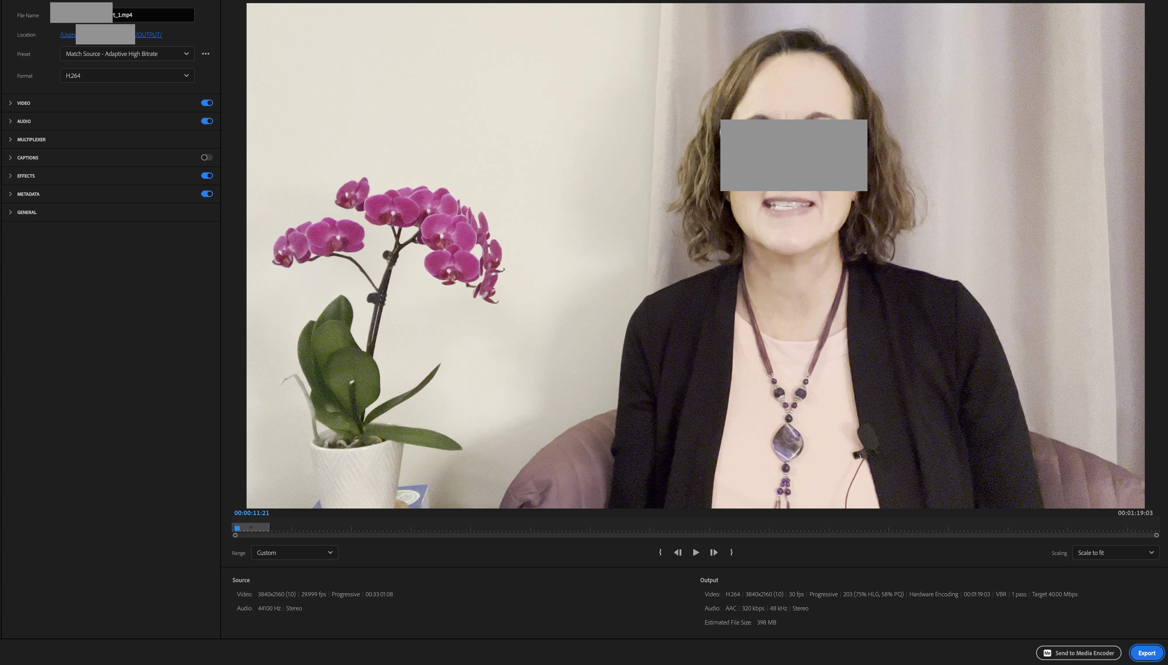

Here is the export window for that same sequence. I just used the default output settings (H.264 Format):

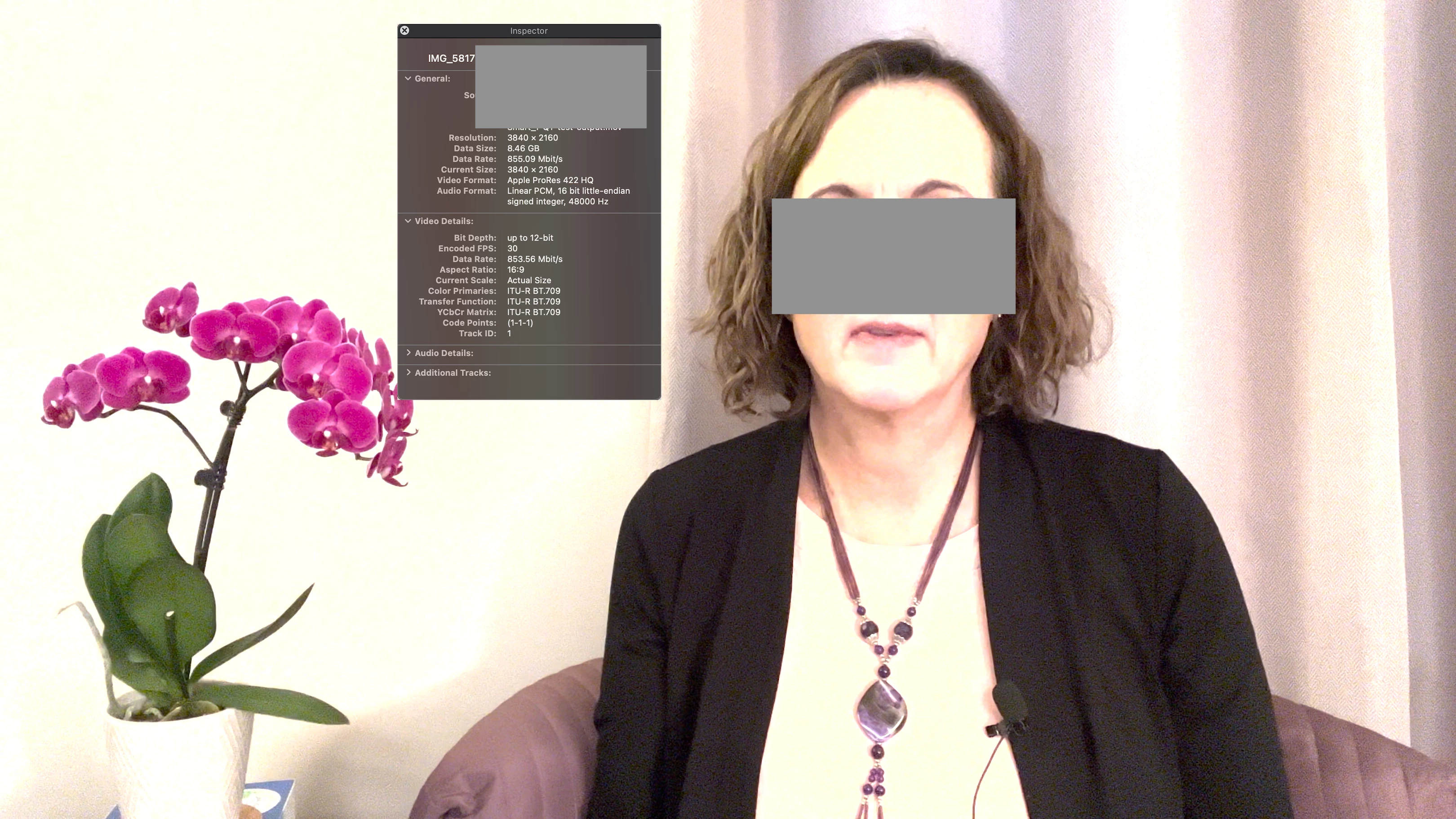

And here is the output of the above sequence to an MOV file. No adjustments made to the file. Just imported, a sequence created from it, and output to a file of the same resolution:
You can see there has been a significant loss in image quality.

That looks like a basic mis-color-management issue.
I'm guessing the clip was shot by an iPhone or other rig creating an HLG file, a form of HDR.
You simply imported the clip to an SDR/Rec.709 timeline, did your corrections, and exported to an SDR/Rec.709 export.
But the clip is actually HLG ... and got exported with HLG values. That's the problem.
  • So ... go to the clip/s in the Project panel.
  • Select one or more.
  • Right-click/Modify/Interpret Footage.
  • At the bottom, set the "Override-to" option to Rec.709.
  • Redo any color/tonal corrections on the timeline.
  • Export again with an SDR/Rec.709 export preset as before.
And you should be fine.
