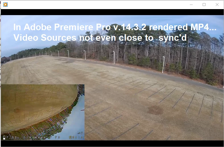

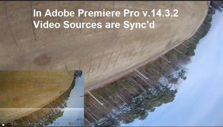

I have the same issue.  I am doing drone footage picture in picture with two vidoes.  Only using sound from one so no audio sync issue.    One camera is a RunCam Orange 5 4K recording 4K at 30fps.  The other is a Fat Shark Sout VR Goggle that records 1136x640 at 60fps.  The VR goggles at the lower resolution is being  used for the picture in picture.  In Premiere, the video play back is spot on.  When exported, it is "pretty" far off.  It makes sense the Frame Rate thing. As you can see in the screen shots below, the 60fps video, when rendered, is ahead for the slower 30fps video.   But setting the FrameRate to 30 didn't work.  They "look" pretty in sync until I roll the drone and then it's obvious they are  like a half second out of sync (see screen grabs below).  I am not much of a video person.  Any suggestions on fix would be appreciated.  I've tried a bunch of stuff but none work.  Just don't understand how it is right in Premiere play back and not when exported.
