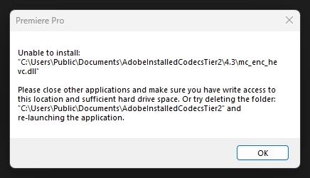

Thank you Kevin. In the meantime, I'm having more serious errors. When I try to open Canon C-Log 3 footage from the Canon EOS R6, there's an error log "Unknown error."
When I click out of that dialogue box, Premiere displays the attached error.
When I click out of that error, Premiere tells me that it can't import the file because I don't have a paid version of Premiere. But I've been a subscriber for years and have an active subscription and the version of Premiere that I'm working with was installed with Creative Cloud while logged in to my acount. It also tells me something about HEVC, yet I do have Microsoft's HEVC installed.
Premiere was working fine until very recently. I installed three plugins (CineMatch, CineDream, and FreeLab). FreeLab is still working normally, but neither of the others will run - CineMatch does nothing, and CineDream crashes with a bug-report dialogue box.
I've tried deleting the HEVC related folder as requested in the error, but it doesn't seem to fix anything; I just get the same error dialogue.
