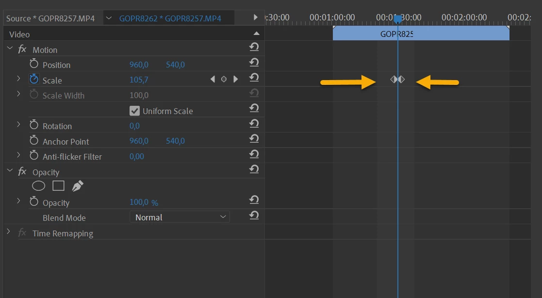

You will have to keep the keyframes within the Frame Hold Segment section.
Uncheck Pin to Clip for better view.
Apr 14, 2021 10:34 PM UTC
Any idea how to extend the Frame Hold Segment section? The clip on the timelone is longer than 2 seconds but in the effects panel it's only keyframable for 2 seconds.

Easier way is to use a frame grab.
