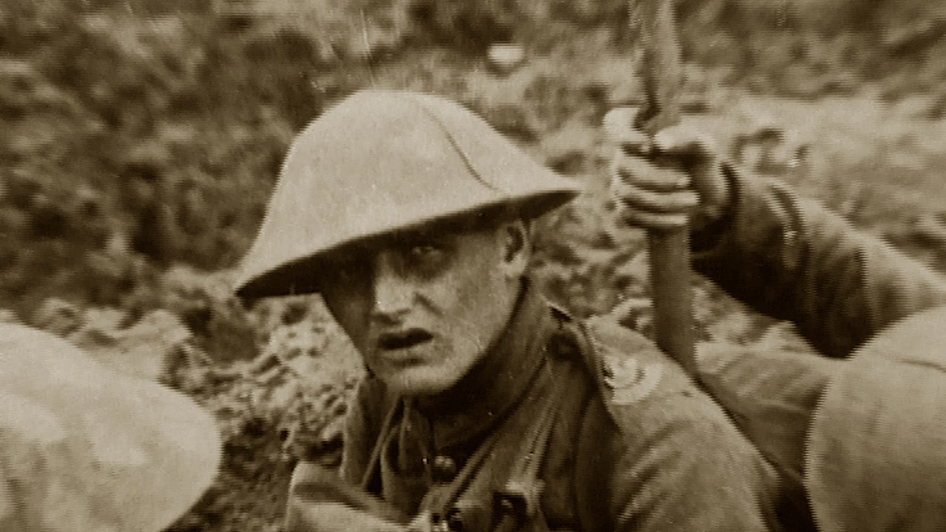

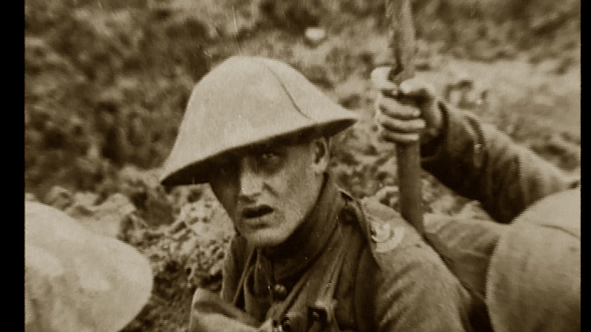

I have an old project that I've just recently re-mastered - from avi 720x576 to ProRes 422 1080p. The frame size and position between the two versions of software is different. EG: In PPro 2022at 10:19:44:10 (and everywhere else) the image is 261 uniform scale, 996w & 540h. As you can see in a still frame from 2022.jpg, it fills the complete frame. However, on importing into 2025 I get the following frame - 2025.jpg - which is also 261 uniform scale, 996w & 540h. I'm at a loss to know what is going on.

OK I can see where a discrepancy lies. In PPro 2022 the file is shown as having a 1.0940 pixel aspect ratio. However, in 2025, the exact same file is shown as having 1.0 pixel aspect ratio. Can you explain why that is the case?
OK, I'm sorted. Thanks for listening. Importing a 2022 project into 2025, did not mirror the imported file's pixel aspect ratio. I needed to modify it manually. I can see where I went wrong.
