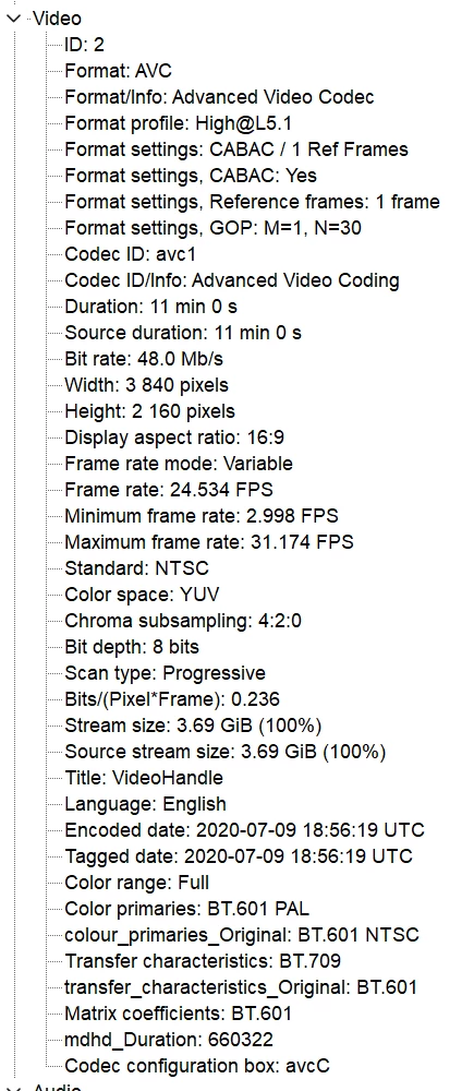

Feb 24, 2025 11:33 PM UTC
To be clear, the audio sync issue can't be fixed by moving the audio back or forth. Sound is generally happening when it's supposed be happening. The video is a vocal performance, and while the original VFR footage has perfect lip sync - all conversions/encodes I've done with this footage ends up with the sound not matching with the lips (while the audio and footage remain generally in sync, e.g., the song stops and people applaud right when it happens in the original footage.
It's almost as if the video is speeding up and slowing down in very fine increments constantly. Sometimes the sound is perfectly in sync, then it drifts out of sync for a few syllables (and honestly the footage does look slow-motion-ish for very quick moments) and then it's back in sync again for another few moments.
I've now tried keeping the footage and Shutter Encoder on my C: drive, which is solid state connected to the MOBO. Same results, whether I use ProRes 422 or ProRes Proxy.
Below is the Tree view from MediaInfo, of my original footage - anything weird?:

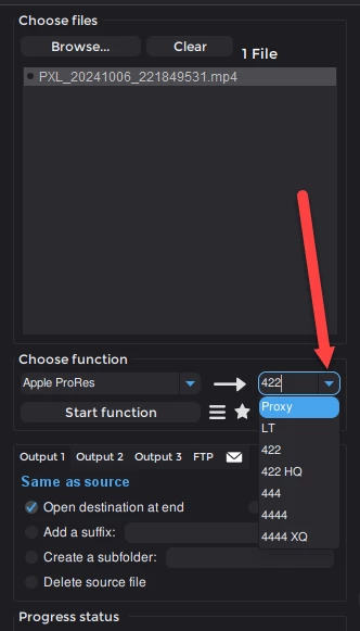

MyerPj
Feb 17, 2025 9:05 PM UTC
Just like you did, using Shutter Encoder but change this drop-down to Proxy (or whatever else you'd like) for the ProRes 'flavor'. 🙂

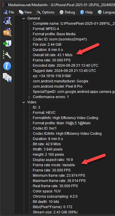

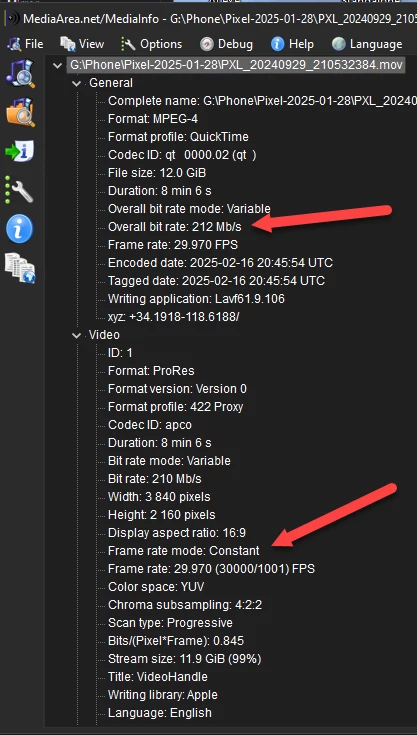

MyerPj
Feb 16, 2025 8:58 PM UTC
I just tried an 8.06 pixel file into SE to ProRes Proxy and the lip sync seems good. How long is your clip?

Feb 17, 2025 4:11 PM UTC
Would you mind reviewing steps you took to generate the ProRes proxy? Did you use AME? Any particular settings other than default?
