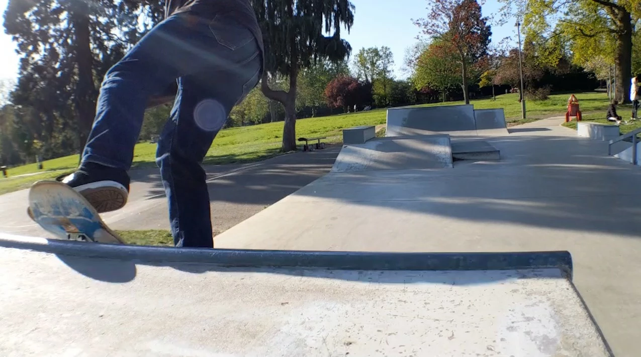

this is a frame from timeline:

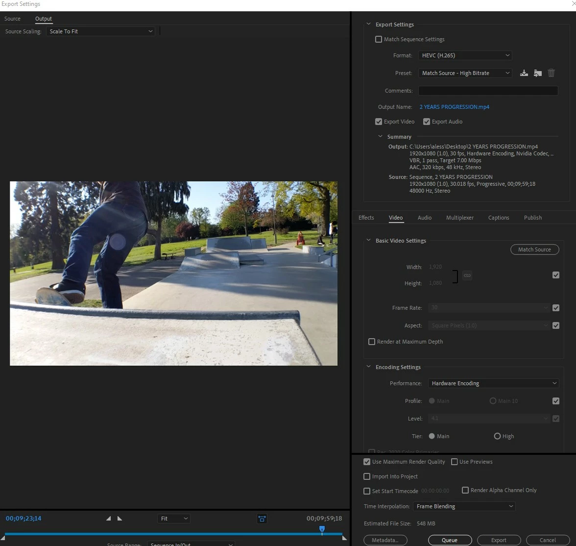

And this is the render settings:

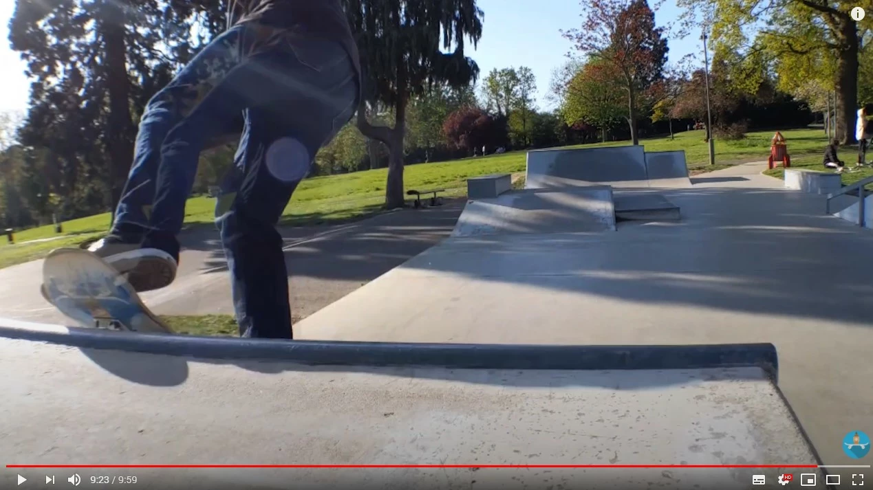

So after the render, this is what I get:
There is a ghosting issue that I can't really get back on track.
In fact, if I try to render just a small portion of the video, seems alright.
I really don't know what could it be.

Correct answer Richard van den Boogaard
Try turn off Frame Blending in the Export Settings (under Time Interpolation).
This is - very likely - the source of your ghosting issue.
Hope this helps.
August 16, 2020
Hope this helps.

Hi, there is no option for that, I can only see three options:
Frame sampling
Frame blending
Optical flow
August 17, 2020
Frame Sampling is the default and the one that you should be using. I agree that I think this is likely the issue - perhaps in combination with the VFR media.
When you fixed your timeline framerate to a standard one it would have removed any need to interpolate between frames, so that also had something to do with the ghosting going away, but the ghosting is a result of the Frame Blending trying to "blend" between two frames.
Your camera records with a variable frame rate. Premiere Pro don´t handle VFR that good. And since you have dragged the clip to the New Item icon Premiere Pro has created a Sequence with a 30.018 fps. You can either go to Sequence > Sequence Settings and change the Frame Rate to 30 fps and try if it fixes anything but it will probably don´t do the trick.
So, download HandBrake and convert your footage to 30 fps and make sure to encode it to a constant frame rate. Use the converted constant frame rate footage in Premiere Pro.

Hi, thanks for the reply.
Can't convert them all, there are tons of clips in the project, with different frame rates, but that's the thing, if I render a smal small portion, just a clip or two, it's fine.
Averdahl
August 16, 2020
Then i would at least make sure that the Sequence is set to 30 fps rather than 30.018. 🙂
Maybe you will need to find the places where it "ghosts" and try to render out small portions of that source footage and patch over the "ghosting" part. Time consuming as well.
