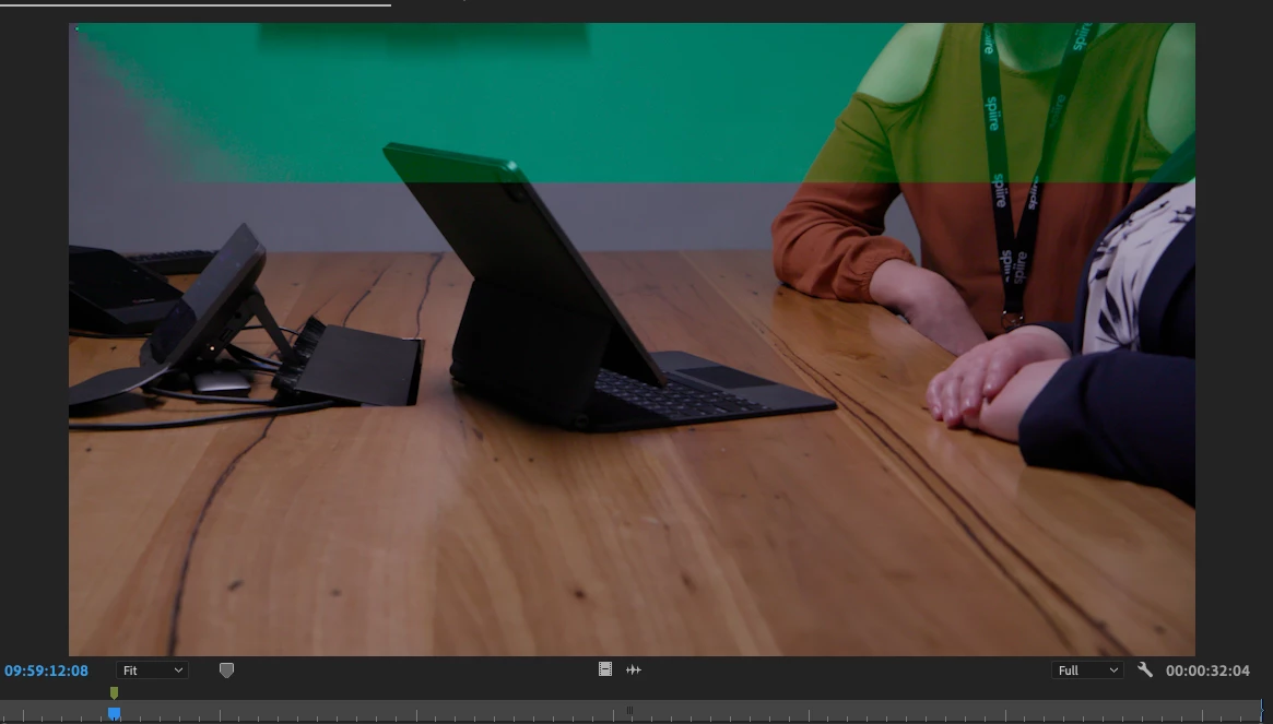

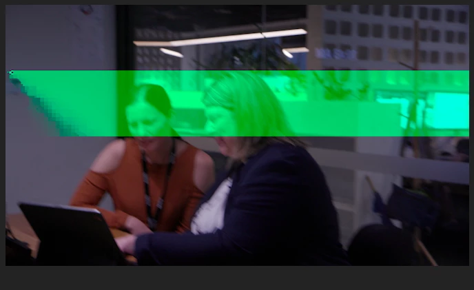

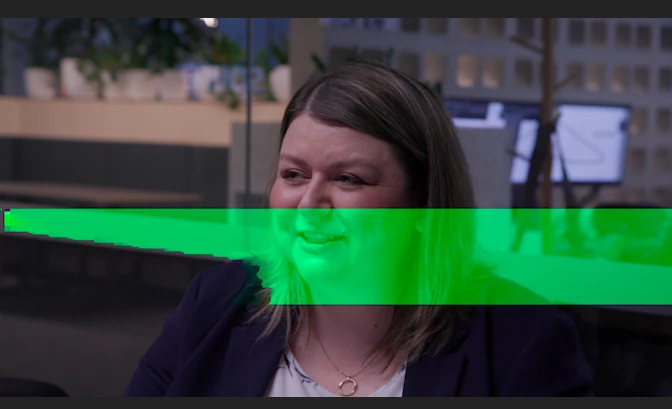

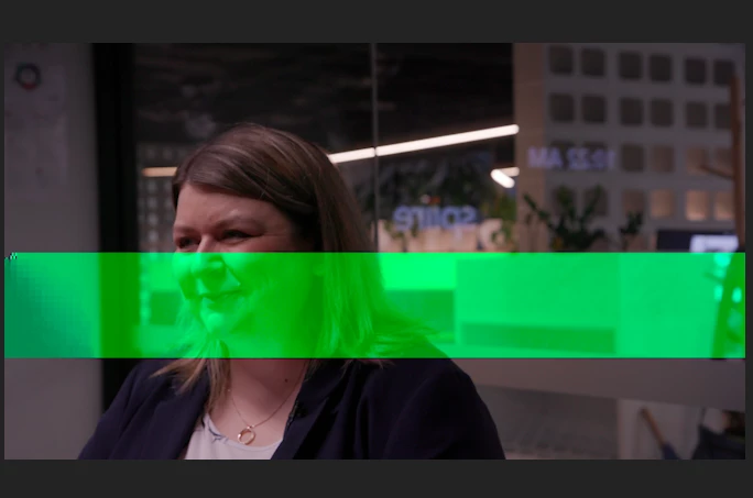

Hi there,
Running both versions of Premiere this still happens on my computer,  MacBook Pro M1 Max.
The footage that has the glitches flash for a frame on every now and then, but always at the same spot. Thought it might have been a camera issue but the problem is not appearing o my colleagues  older mac.
The glitch has all of a sudden started appearing on shots from Canon c300 MkII. But I have been editing video files before on the computer without this happening before. Have attached glitch examples.
Have tried other fixes for known issues like turning off Hardware Encoding or the beta version, but it's not working.
Please help me!

Here's a link to a clip where the error occurs for me (on my computer it occurs at 13:10 secs:frames or at 09:57:13:14 of the timecode) as can also be seen on the screenshots attached.
https://drive.google.com/drive/folders/1sTV-SVVoFXvLED6sDeL8zu0Q6Db1jQ28?usp=sharing
The fixes listed by chrisw44157881 's response do not work btw.
