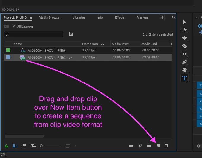

    Do the following: do the sequence again but drag and drop clip from the Project panel to the New Item icon to create a sequence from the clip, then edit it, export it and tell me how it went (don't touch the parameters of the created sequence, just edit there).
    byroncortez Test
    Byron.

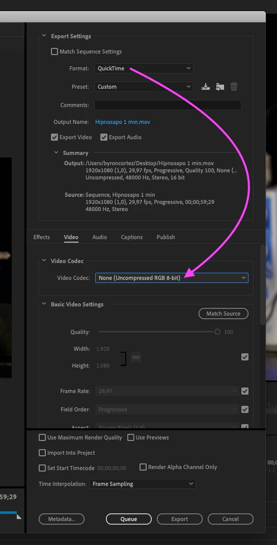

    Now try without compression. Try this.
    Byron.

    Still seeing the glitch ... I also tried the uncompressed 10-bit option.

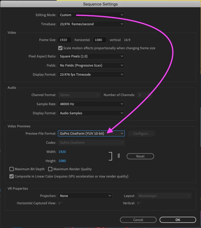

    Now try deleting Media Cache files in Pr Preferences, if not, in menu Sequence / Sequence Settings... change the Editing Mode to "Custom" and Preview File Format to "GoPro CineForm" to see how it goes, but first make a backup of your project and the sequence into project (make a duplicate of the sequence).
    Byron.
    October 15, 2019
    No luck here either ...
