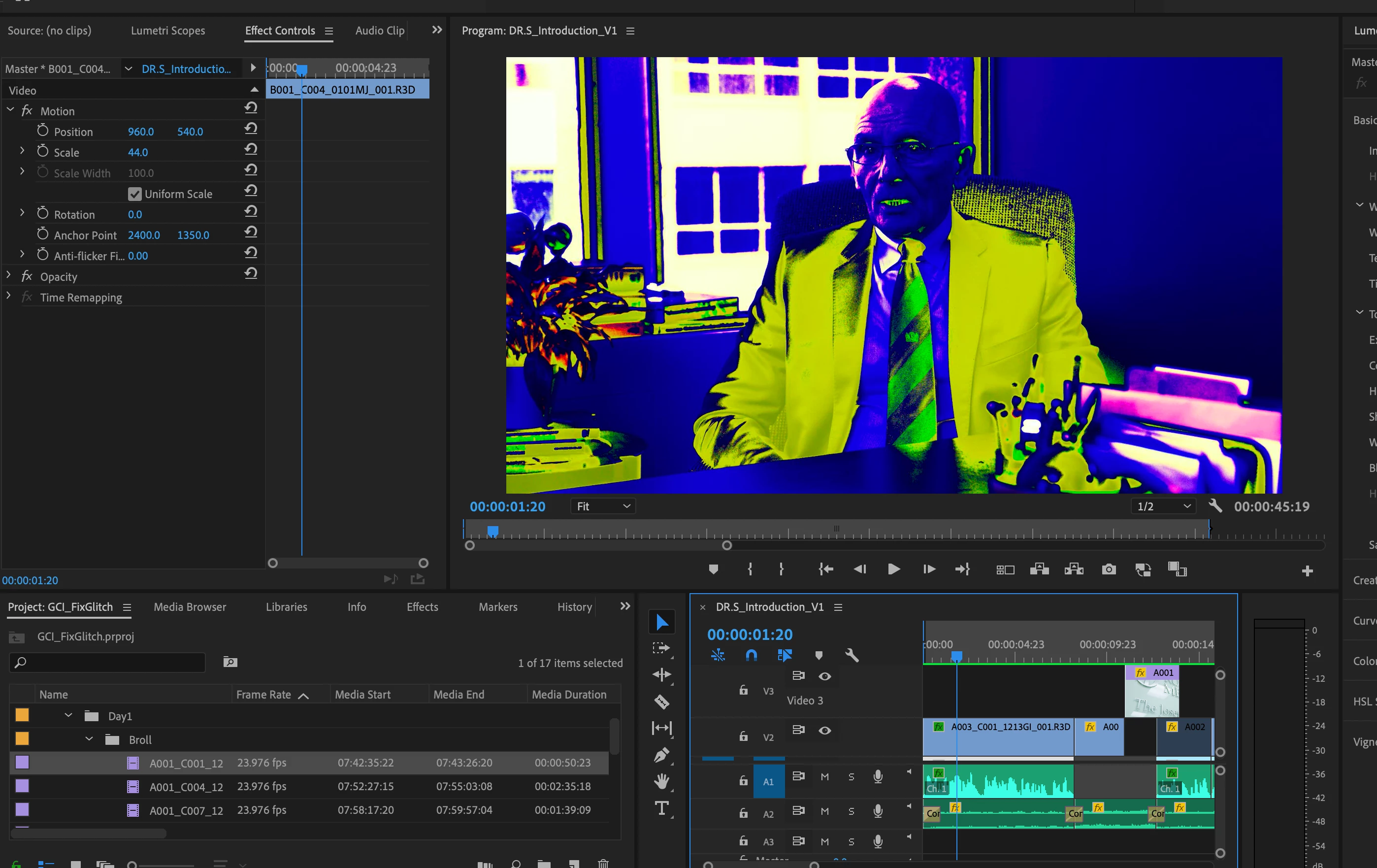

When I render my Red footage in premier i get a blue green glitch that comes across the footage. It seems to be only to footage that I have added Lumetri color to. Looking for a fix, or the answer to what im doing wrong. I have never seen this before.

I've got a couple current projects with 6k RED on them, and they work fine both on my desktop and laptop. Both Win10, desktop with an Nvidia 1060/6GB, laptop with a 2080 (laptop version). But those are very different than your Mac OS/AMD video card system.
But without Lumetri, they show "normal" ... hmmm. Although I don't see Lumetri applied to the clip in your example, unless you applied it via the MasterClip settings. If these are RED full r3d files, how well are they responding to the RED settings in the MasterClip tab of the ECP?

Definitely a problem with the driver used by that computer. Changing Apple involved drivers is less easy than any other OS, but ... that's what the problem is.

Thanks Neil,
Is there a reason this is just happening now? Is the footage im working with to large for my graphics card? I have edited 4k footage on this computer for months and never had an issue until this project, some of this footage is 6k is that the issue?

There are problems with the latest Nvidia driver, and this may be related. Do you have an Nvidia GPU?
At any rate, to check for GPU issues go into the Project settings and set Mercury Acceleration to Software Only. If that fixes this, it's a GPU issue.
If so, try changing GPU drivers.

December 20, 2019
Thank you for your response. I have a Macbook Pro with Radeon Pro 555X 4 GB Intel UHD Graphics 630 1536 MB. Yes when I set it Mercury Playback Engine Software Only it seems to go away. But is going to take hours to export my project.
