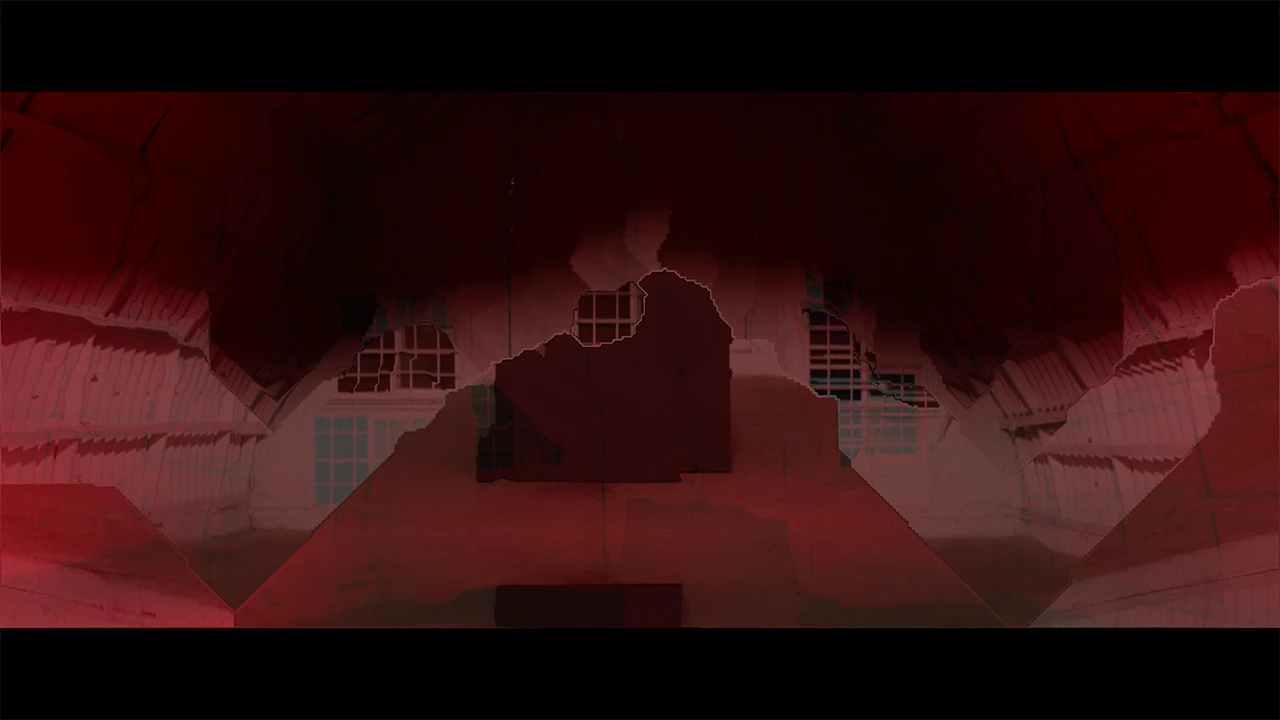

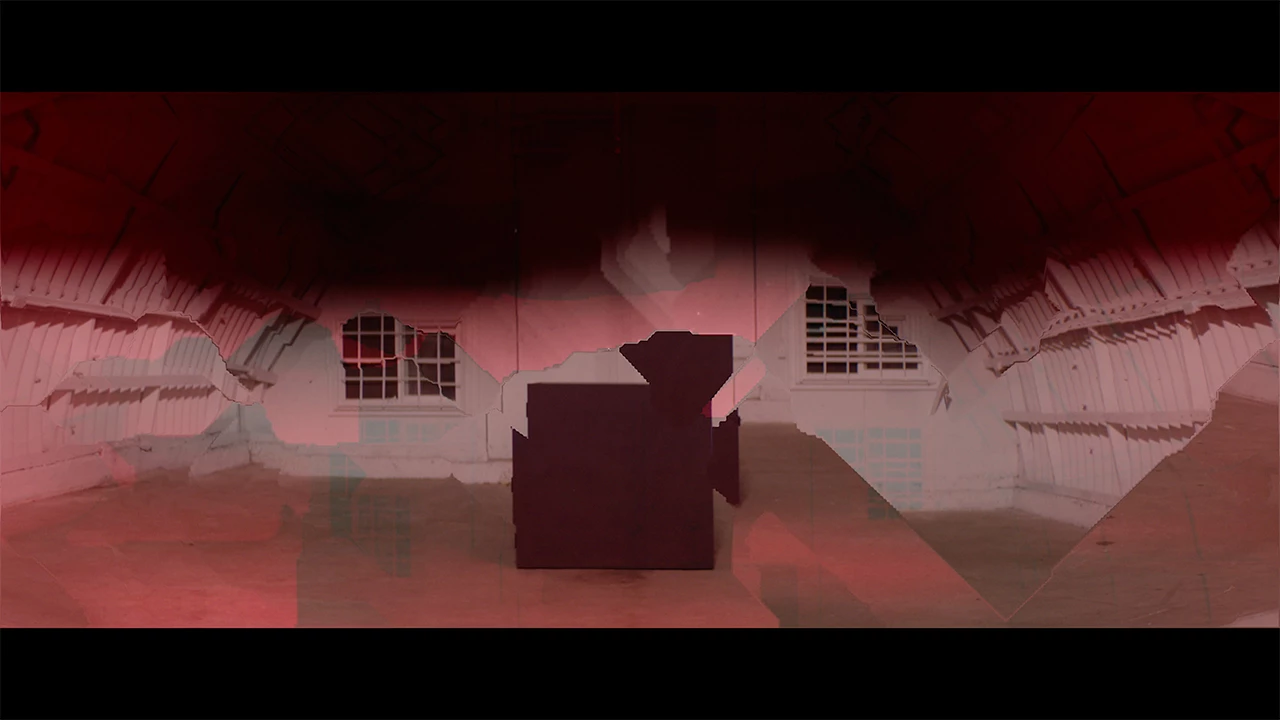

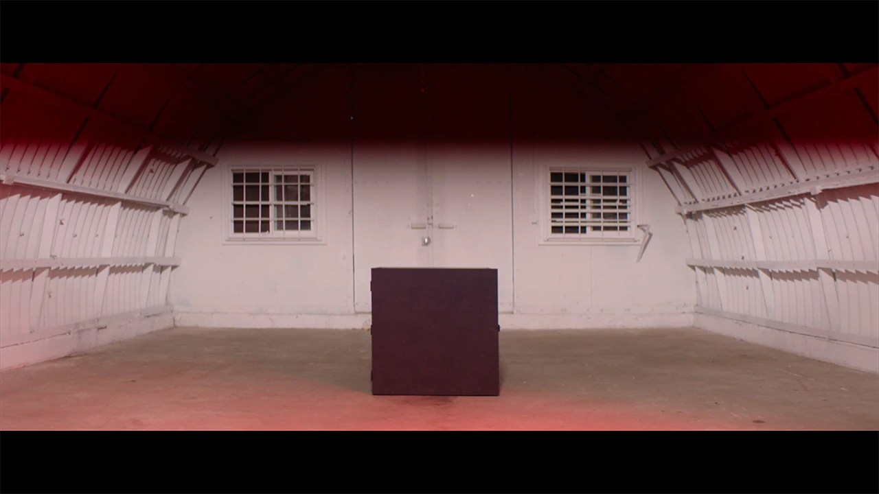

It seems it may be an issue with dropping frames, but I can't figure this out based on other postings regarding mixed frame rates and such. The footage plays normally in Premiere, but upon exporting, in multiple different codecs, I get this strange glitching every time the strobe lights flash in the video. The footage is also slowed down to 85% speed, but I've tried changing this to 100% and 80% (to match the 23.976 frame rate of the project) but it doesn't make a difference. I have tried Posterize Time, changing to software encoding, and messing with bitrate settings but I'm still getting the same issues. If anyone has any suggestions or has encountered a similar problem please... help!!!
I've attached examples of the glitch, the 4th image is a screenshot from Premiere showing what it SHOULD look like.

That all looks fine. I was going to suggest ProRes to rule out compression artifacts but if you've already tried that then there's no solution there.
This HAS to be because the footage is being slowed down and the frame rate is being changed. Can you try a test? Take a clip with the strobe in it and create a new sequence that matches it; it will be a 120fps timeline. Do not change the speed on the clip in any way. Export to ProRes and see if the glitch is present.
JVK

It does seem to only light a portion of the frame each time, a sort of banding effect, but that was just an oversight on the day and the look doesn't bother me. It's only the digital artifacting/ghosting sort of thing that occurs with each flash that I want to get rid of. It seems like Weirdsmobile's suggestion was correct though - I just have to create a separate sequence at the right frame rate for the slomo, then drag it into the 24.976 project.

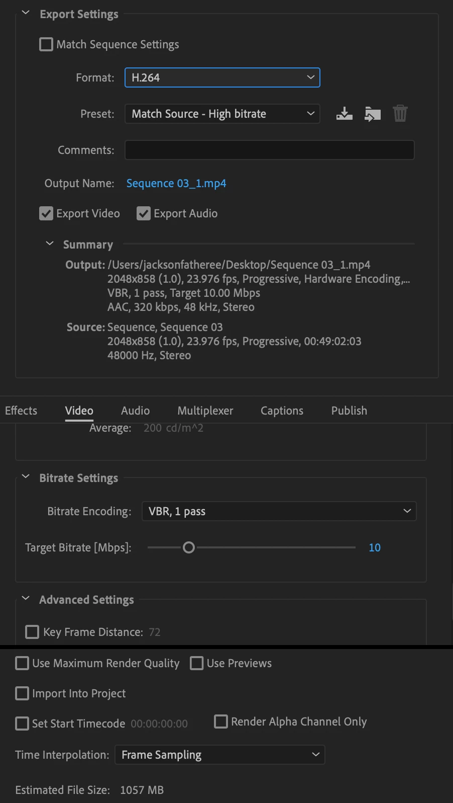

What are your export settings? What codec and bitrate (if applicable)?

I have tried exporting in H.264 and Quicktime/ ProRes with the same results; bitrate settings I generally leave to default as I don't know enough to tweak them in a way that might be helpful. This is generally how I've been exporting cuts:
