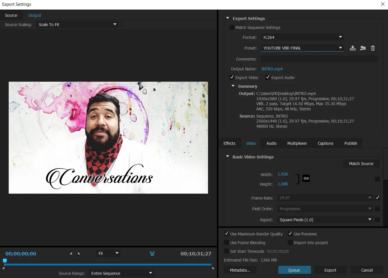

    Ann Bens
    January 8, 2019
    Its either quality or fast encoding: cant have both.
    Post screenshot export settings: 12 hours upload for 25 minutes is way too long.

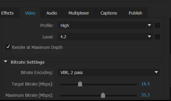

    Peru Bob
    January 8, 2019
    Is there a reason you have Render at Maximum Depth checked?
