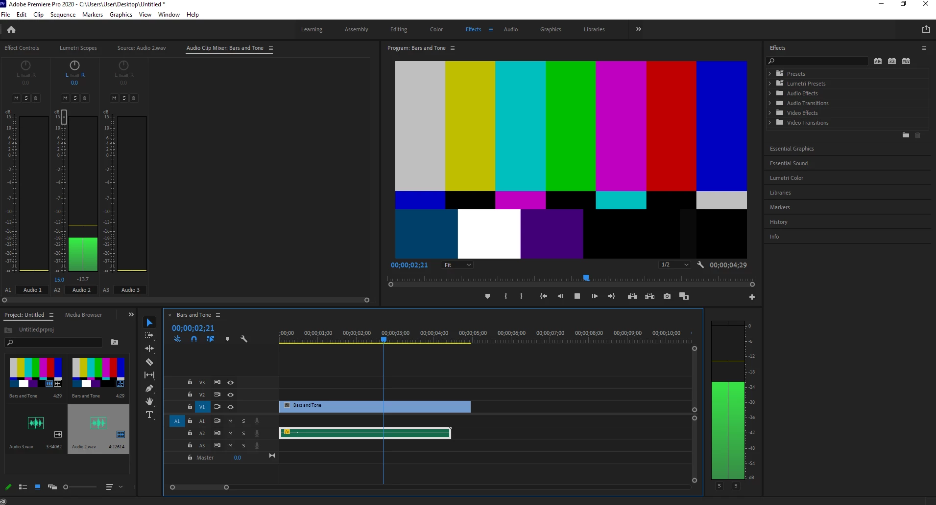

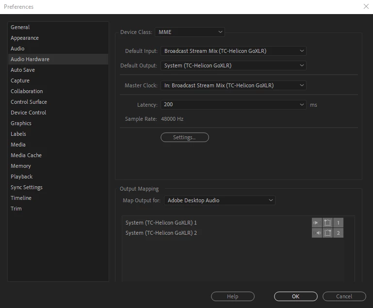

Having an issue with Premiere Pro where my Voice Over Recording Audio is incredibly quiet. To the point where raising the db levels to +15 (the max) it is still very hard to hear. I am using a GoXLR Audio Interface, my question is for those who use that system.
What is your setup for the Input, Output, Master Clock and Map Output? I consulted a forum post that had a similar issue to mine about a year ago, but the "solutions" on that post did not resolve my issues. I am not able to find any where that says how to properly line the audio for the GoXLR with Premiere Pro so that I may record voice overs within the program.
Below are snapshots I took of my Audio Configuration (it may be setup horribly wrong, I wouldn't know so that's why I'm asking). As well as some recorded Voice Over Audio with +15db to the audio to show that the audio is not being captured properly, hence me asking what I can do to fix it.

What output does that unit put out ... line, what? How do you have it connected to the computer, USB or line-in or mic jack ... what? And what settings does it have for output gain?

Hi Neil, thank you for taking the time to respond and look into my issue. I apologize for not giving a response sooner. I have my GoXLR device connected via USB. As far as the settings for my device, I have all of them listed below. I am putting all of my mic settings just in case it helps narrow down my issue.
Mic Gain: 46 db via Condenser (+48v)
Gate - Amount = 32
Threshold: -40db
Attenuation: 100%
Attack: 10ms
release: 200ms
Equalizer - Bass = -3 / Mid = -1 / Treble = -3
31.5Hz: -9
63Hz: -5
125Hz: 2
250Hz: -1
500Hz: -3
1KHz: -2
2KHz: 1
4KHz: -2
8KHz: -5
16KHz: -3
Compressor - Amount = 85
Threshold: -32db
Ratio: 4:1
Attack: 2ms
Release: 100ms
Make-Up Gain: 5db
De-esser - Amount = 30
Again, I'm not experienced with this kind of audio device so if I didn't provide enough answers please let me know where I should look for said answers so that I may get them to you.
