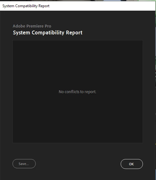

Kevin J. Monahan Jr.
January 7, 2020
SB,
Sorry my friend. Check Help > System Compatibility Report. Then, post a screenshot. Let's see if your drivers are being detected.
Kevin
Need_Not
Need_NotAuthor
January 7, 2020
not much 😕😕
