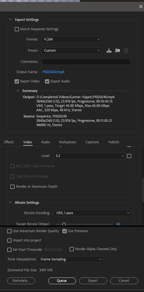

    You are exporting to a preview codec. Is that your intention?
    Post screenshot of export settings.

    The image I posted was just me rendering the Timeline Preview.  I get the error there or when exporting the finished file.
    Export settings to follow.  These are not my typical settings.  Usually I "Render At Maximum Bit Depth", and "Use Max Render Quality" as well as running VBR 2 pass.  I brought myself to these settings to attempt to correct this issue.  Figuring the less intense the Render/Transcode process the less likely I'd have an issue.
