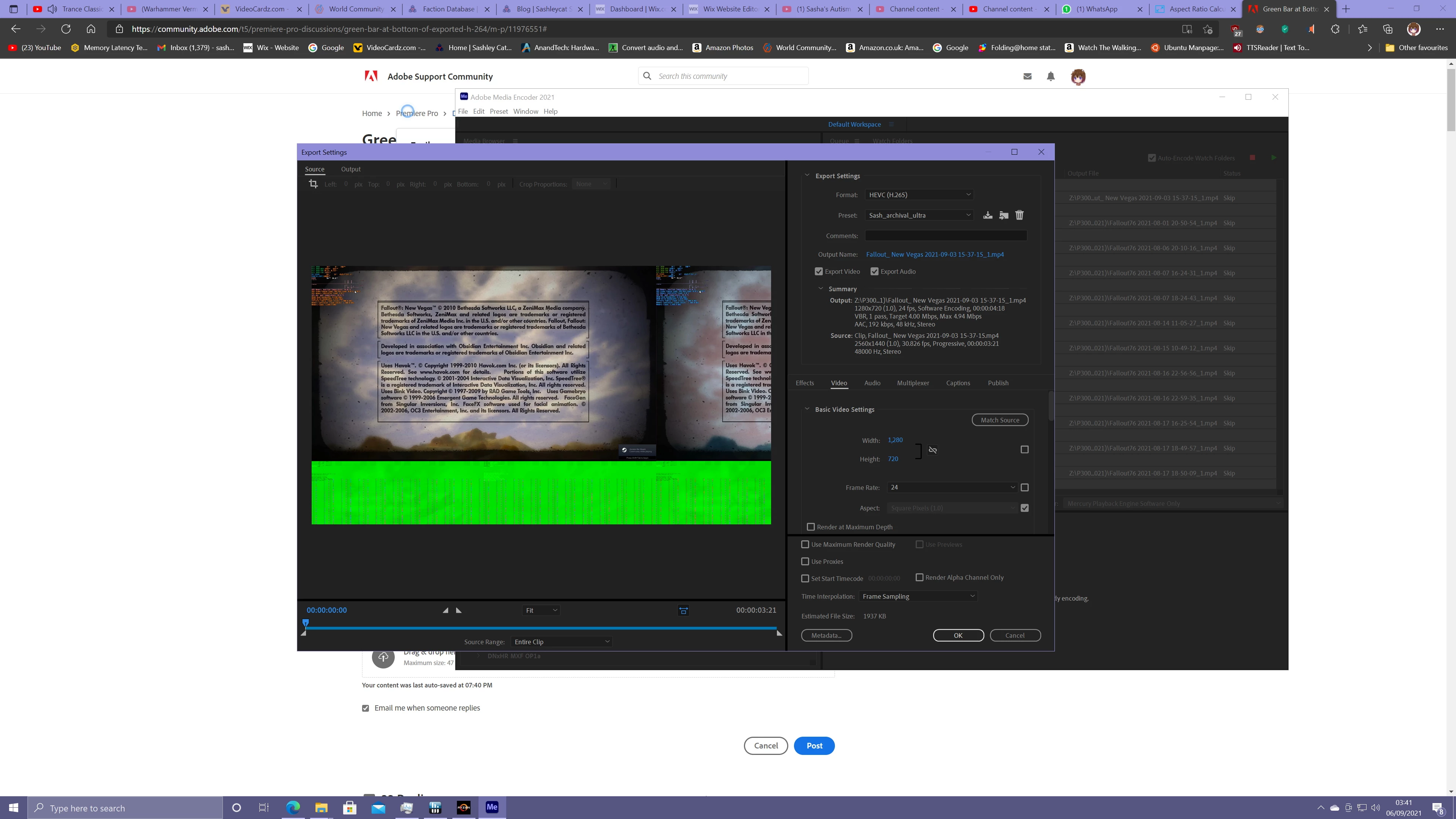

Exporting my videos from Adobe Premiere Pro 2020 to H.264, I'm getting a green bar across the bottom. The primary footage in my sequence are mp4's

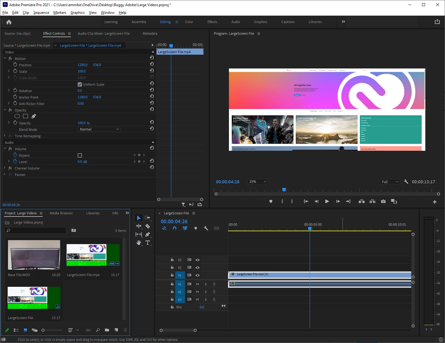

I think this is a bug on Adobe and let me explain my scenario and maybe the experts can chime in or tell me how to fix the issue, since I am seeing the green bar as well.
Setup:
- Win10 20H2 (OS Build 19042.1110)
- EVGA GeForce RTX 2080 XC GAMING, 8GB GDDR6 (Drivers updated to version 471.41 7/19/2021)
- Adobe Premiere 15.4.0 (Build 47)
- 32GB RAM
- Ryzen 7 2700X
I have a large monitor (3440x1440) and I recorder a dummy video using the Xbox game bar of the screen. This produces a video file resolution of 1920x804.
I also have a sample file I recorder with my iPhone which results into a video file resolution of 1280x720.
Repro Steps:
- Create a new Project in Adobe Premiere and add the two video files to the project.
- Grab the iPhone file (1280x720) and drop it to the timeline first.
- Grab the large screen video file (1920x804) and add it right next to the iPhone file in the timeline.
- CTRL+M to bring up the export options screen.
- In the output preview section, drag the slider and notice how the first video preview looks great.
- As soon as you start sliding towards the second video section, you will start to see the green bars, but only in parts of the video. See video of the bug attached.
Additional Info:
- If you drag the large video file (1921x804) and drop it to the timeline first, it will actually display great in the editor preview, you can actually play it and it renders fine most of the time (sometimes you do see the green bar glitch, but it goes away after a little bit). It is only until you go to export (no matter what export type you chose, even GIF will repro the bug) that the issue happens. If you notice closely in the  propject files thumbnails, you will actually see the green bar as well:
I think this has to do with the large file that got saved in a weird resolution, but I think adobe should support that or at the very least let the users know right away that the file resolution is weird and it won't export it fine.
Kevin J. Monahan Jr.
July 21, 2021
Hi Acua,
Try transcoding the footage to ProRes LT. Then show us a screenshot of your export, please.
Kevin

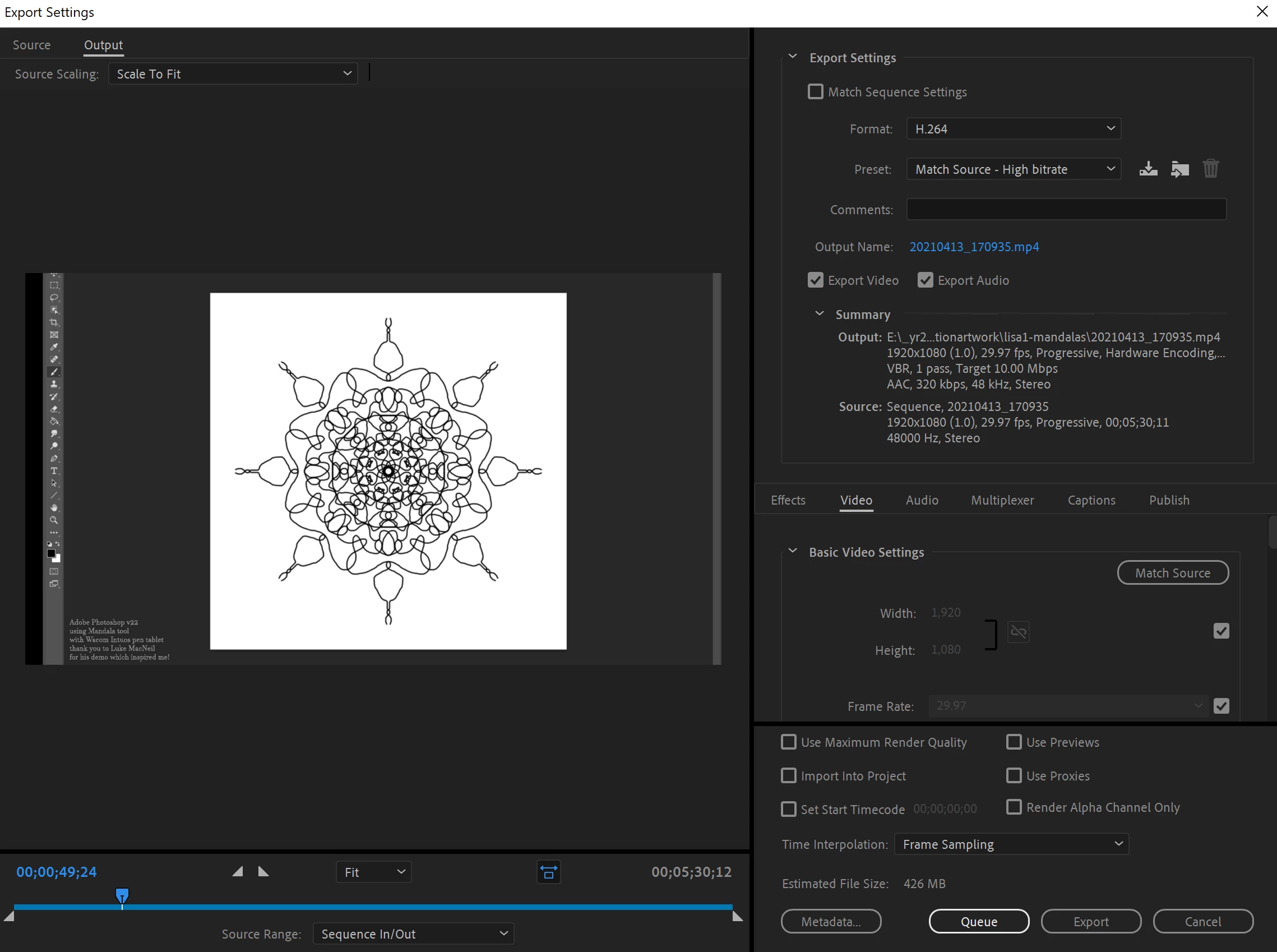

Christian.Z
May 25, 2021
Please provide detailed specs of your system, including your storage configuration as well as your OS and version of Premiere
Can you please provide us with the original footage file info, sequence settings and export settings?
Lisa Shea Author
May 26, 2021
I am running Premiere Pro version 15.2.0 Build 35. I'm on Windows 10 Pro 20H2. My main system drive is a Samsung SSD 860 EVO 1TB which is about 1/4 full. I posted the graphic card info separately for someone else.
I recorded the source footage directly on my computer while in Photoshop, showing me making mandalas in Photoshop. I think I used the built-in Microsoft windows-G to record the footage. The files say they are 30.01fps by "Microsoft Game DVR". In premiere they report as 30.00 fps. In the project, I have a short intro piece of 29.95fps before my mandala video. The sequence as a whole matches that 29.95fps.
I had made this project on April 13th for a project and everything worked perfectly. There were no issues at all. That exported video is live and functional.
I went back into the file recently to make some changes to it. Without any changes, the exact same file which worked perfectly before is now, on export, showing the green horizontal bar and not-zoomed-in ratio.

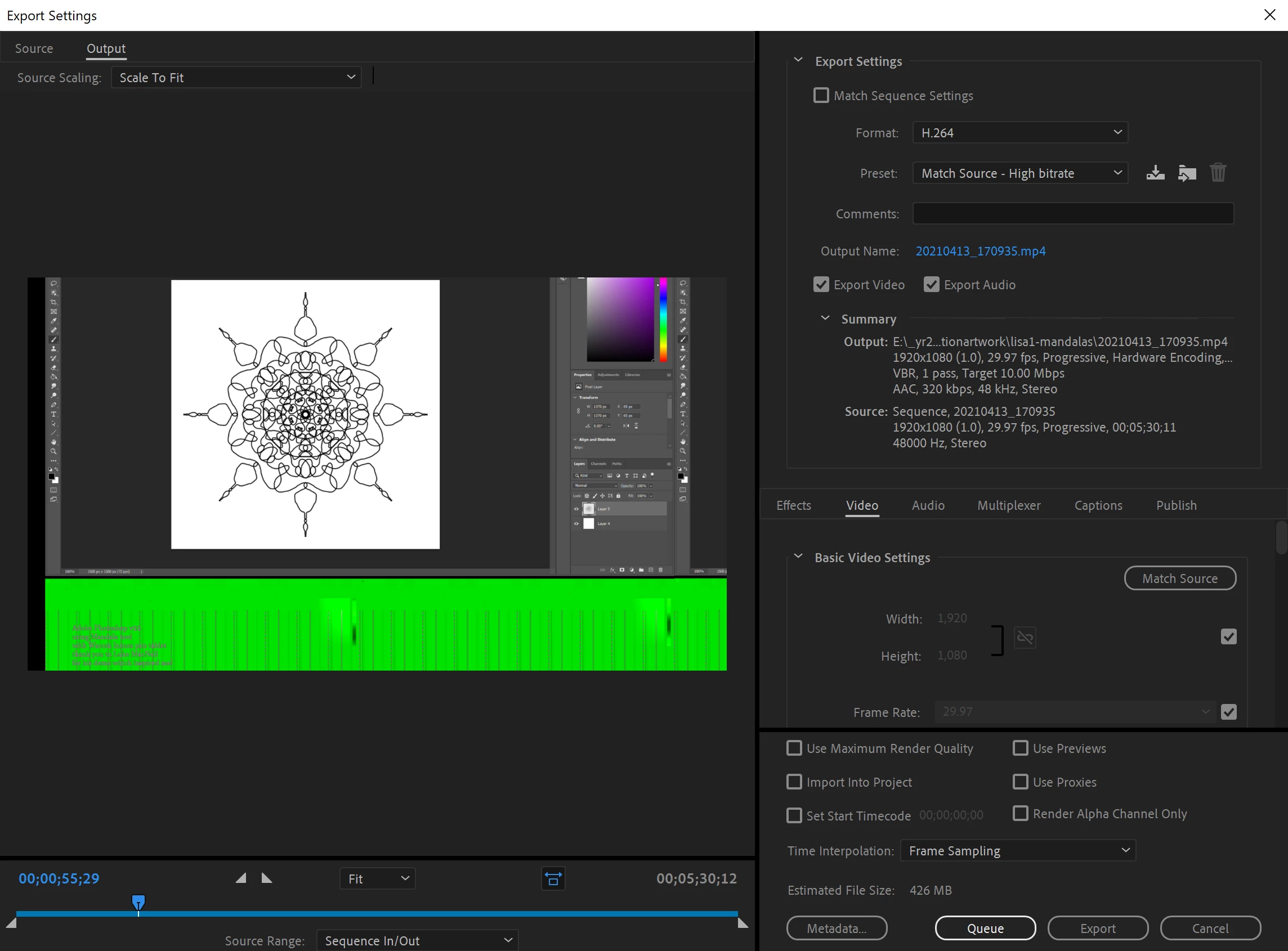

Peru Bob
May 26, 2021
quote
By @Lisa Shea Author
The file is likely variable frame rate.
Please use the free MediaInfo and post a screenshot the properties of your media in tree view:
https://mediaarea.net/en/MediaInfo
Many users are having issues with VFR.  Use Hand brake to convert to constant frame rate:
https://handbrake.fr/downloads.php
Here is a tutorial:
https://www.youtube.com/watch?time_continue=34&v=xlvxgVREX-Y

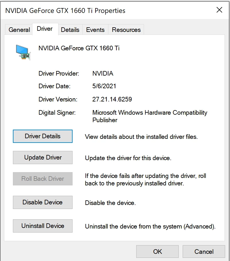

Lisa Shea Author
May 26, 2021
Yes, I am using the latest NVIDIA studio driver for my card. I just went onto the NVIDIA site and verified. Here are the specs.
